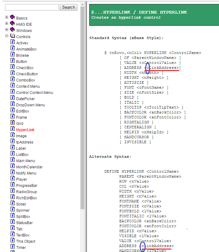

I will wait for your answer for Prg2Fmg and I prepare a richest example of HYPERLINK but first I need your return.
I've checked in the forum , SAMPLES and DOC it's saying the property is a string and for me it's very important to keep it in _HMG_SYSDATA [ 8 ].
What I see that _HMG_SYSDATA [ 8 ] is useful in many other controls as a second reference/support.
I do not know how long it's like that...
Please, keep it.
