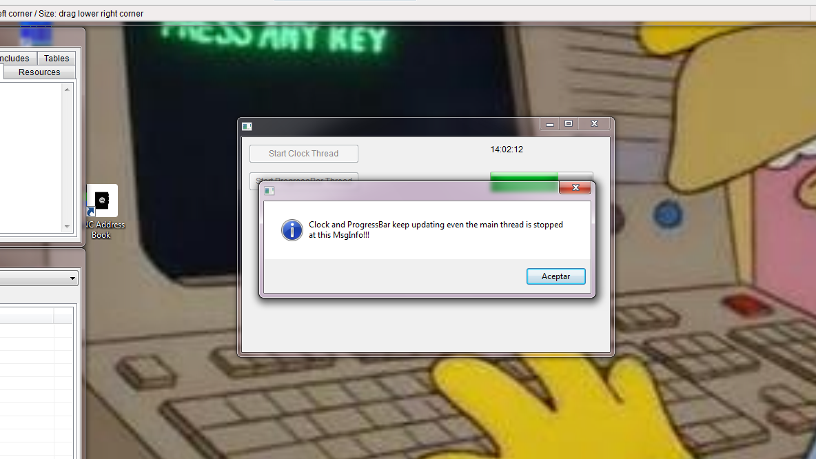

To test the concept, another button (button_3) will show a MsgInfo (that will stop the main thread) while the clock and the progressbar stills updating...
declare window Main
Function main_button_3_action
	MSGINFO('Clock and ProgressBar keep updating even the main thread is stopped at this MsgInfo!!!')
This is how it will look like (please, believe me, the clock and progressbar stills updating :) )
