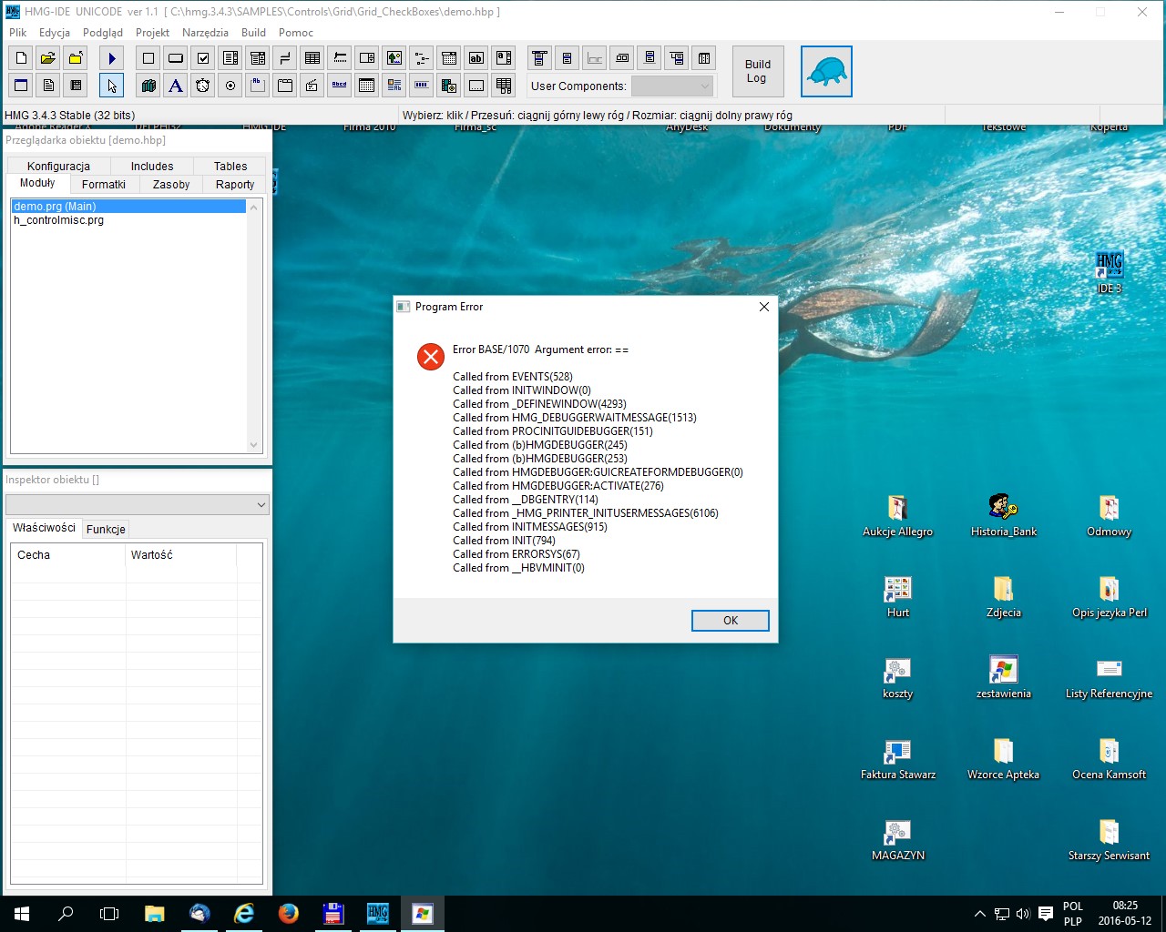

I tried to run the debugger joining the project h_controlmisc.prg to trace where the problem is but when you start getting an error:
HMG Errorlog File
Date:05/11/16 Time: 19:26:56
Error BASE/1070 Argument error: ==
Called from EVENTS(528)
Called from INITWINDOW(0)
Called from _DEFINEWINDOW(4293)
Called from HMG_DEBUGGERWAITMESSAGE(1513)
Called from PROCINITGUIDEBUGGER(151)
Called from (b)HMGDEBUGGER(245)
Called from (b)HMGDEBUGGER(253)
Called from HMGDEBUGGER:GUICREATEFORMDEBUGGER(0)
Called from HMGDEBUGGER:ACTIVATE(276)
Called from __DBGENTRY(114)
Called from _HMG_PRINTER_INITUSERMESSAGES(6106)
Called from INITMESSAGES(915)
Called from INIT(794)
Called from ERRORSYS(67)
Called from __HBVMINIT(0)

Thank you for your answer Dr. Claudio Soto, but the compilation of the file h_controlmisc.prg attached to the project ends with an error as shown in the Annex. Of course, I fixed line in 2843 and he has compiled the file h_grid.prg

Piotr, do you have incremental compilation turned on? Maybe reset incremental data and rebuild project

Na to wpadłem, resetowałem, ale błąd się powtarza.
Pozdrowienia
Piotr
Hello
It ran, reboot, but the error persists.
greetings
Piotr

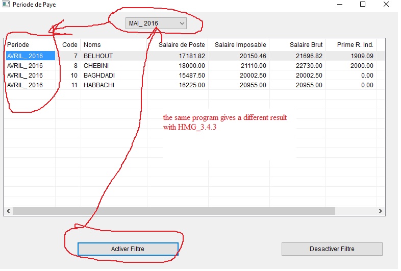

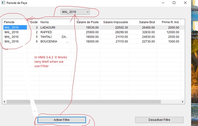

the same program compiled with HMG_3.4.2 gives different results in HMG_3.4.3
Compiled with HMG 3.4.3
Compiles With HMG 3.4.2

tonton2 wrote:the same program compiled with HMG_3.4.2 gives different results in HMG_3.4.3
I will check.
