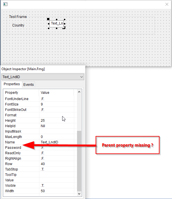

In the HMG Reference I read there are controls that have a parent property, available at control definition, e.g. a Label and a TextBox. But when I design a screen, and put some labels and textboxes on it, I don't see that parent property. Shouldn't it be there in the design screen ? See image.
Kind regards, Marc

TopsMarc wrote:Hi,
Kind regards, Marc
"Parent" property is the window (form) name that this control is on. In particular, "parent" property is meaningful for control(s) defined outside of its window (form) definition.
In IDE it's impossible to define a control without his "parent" nor define a control outside of this (active) form. Because you should define a window (form) before any control is on.
So, in IDE is meaningless define a "parent" to any control.

Hi mr. Esgici, Thank you for this clarification. Kind regards, Marc
