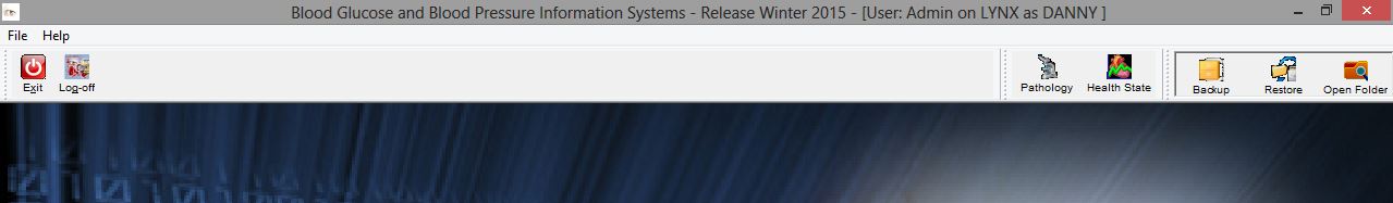

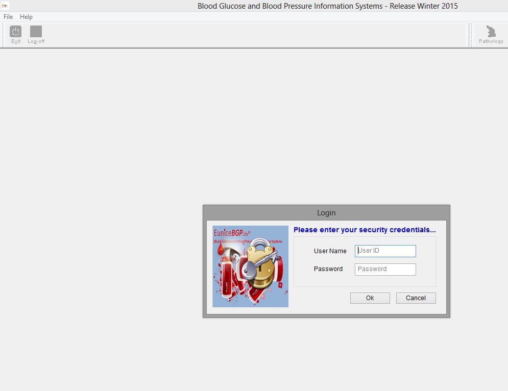

static function BeginLogon()
   LOCAL LoginCancelled
   MainForm.tbrMain.btnExit.Enabled := .f.
   MainForm.tbrMain.btnLogOff.Enabled := .f.
   MainForm.tbrMaint.btnPath.Enabled := .f.
   MainForm.tbrArchive.btnBackup.Enabled := .f.
   MainForm.tbrArchive.btnRestore.Enabled := .f.
   MainForm.tbrArchive.btnExplore.Enabled := .f.
   MainForm.imgMainBK.Hide()
   LoginCancelled := oUser:UserLogin()
   IF oUser:AccessDenied
      MSGSTOP( "Excessive log-on tries is not allowed. Program will be terminated.","Access Denied")
      DestroyWindow()
   MainForm.Title :=  IIF( EMPTY( oUser:currentUser() ), MainForm.Title, " " + ProductName() + " - [User: " + PROPERCASE( oUser:currentUser() ) + ;
                        " on " + GETENV( "COMPUTERNAME" ) + " as " + UPPER( GETENV( "USERNAME" ) ) + " ]" )
   IF LoginCancelled = FALSE
      DestroyWindow()
   IF alltrim( oUser:aUserInfo_[ 1 ] ) == "ADMIN"
      MainForm.mnUser.Enabled := TRUE
      MainForm.mnUser.Enabled := FALSE
   MainForm.tbrMain.btnExit.Enabled := .t.
   MainForm.tbrMain.btnLogOff.Enabled := .t.
   MainForm.tbrMaint.btnPath.Enabled := .t.
   MainForm.tbrArchive.btnBackup.Enabled := .t.
   MainForm.tbrArchive.btnRestore.Enabled := .t.
   MainForm.tbrArchive.btnExplore.Enabled := .t.
   MainForm.imgMainBK.Show()

Here's my beginlogon() windows definition.
METHOD UserLogin() CLASS UserManager
   LOCAL lRetVal := FALSE
   LOCAL acUser_ := ARRAY(3)
   PRIVATE nTries := 1
   PRIVATE lActivated := .f.
   PRIVATE lSwitchOff := .f.
   PRIVATE lUserName  := .f.
   DEFINE WINDOW frmLogin;
      AT 0,0;
      WIDTH 485 HEIGHT 222;
      TITLE "Login";
      ICON "MAINICON";
      MODAL NOSYSMENU ;
      FONT "Arial" SIZE 9 ON INIT ::Open() ON RELEASE ::Close()
      @  52,210 LABEL lblUserName OF frmLogin VALUE "User Name";
         ACTION Nil WIDTH  70 HEIGHT 20 FONT "Arial" SIZE 9
      @  87,210 LABEL lblPassword OF frmLogin VALUE "Password";
      @  48,290 TEXTBOX txbUserName OF frmLogin HEIGHT 24 VALUE "" WIDTH  120;
         FONT "Arial" SIZE 9 TOOLTIP "" MAXLENGTH 10 ON LOSTFOCUS Nil;
         ON ENTER ( frmLogin.txbPwd.Setfocus, frmLogin.txbPwd.CaretPos := 0 );
         ON CHANGE ::tbxChangeArg( This.Name )
      @  84,290 TEXTBOX txbPassword OF frmLogin HEIGHT 24 WIDTH  120;
         PASSWORD MAXLENGTH 10 UPPERCASE ON LOSTFOCUS Nil ON ENTER lRetVal := ::LoginButtonOK(@acUser_)
      @  84,290 TEXTBOX txbPwd OF frmLogin HEIGHT 24 VALUE "" WIDTH  120;
         MAXLENGTH 10 ON CHANGE ::tbxChangeArg( This.Name )
      @  10, 10 IMAGE imgLogo OF frmLogin PICTURE ::cImageFile WIDTH  150 HEIGHT 160 STRETCH
      @  10,130 IMAGE imgLock OF frmLogin PICTURE ::cImageHome + "key.bmp" WIDTH  30 HEIGHT 30 STRETCH
      @  10,170 LABEL Label_3 OF frmLogin VALUE "Please enter your security credentials...";
         ACTION Nil WIDTH  280 HEIGHT 20 FONT "Arial" SIZE 11 BOLD FONTCOLOR BLUE
      @  30,170 FRAME Frame_1 OF frmLogin CAPTION NIL;
         WIDTH  280 HEIGHT 100 FONT "Arial" SIZE 9 BACKCOLOR Nil FONTCOLOR Nil OPAQUE
      @ 140,280 BUTTON btnOk OF frmLogin CAPTION "&Ok" ACTION lRetVal := ::LoginButtonOk(@acUser_) WIDTH 80 HEIGHT 24 FONT "Arial" SIZE 9
      @ 140,370 BUTTON btnCancel OF frmLogin CAPTION "&Cancel" ACTION lRetVal := ::LoginButtonCancel() WIDTH 80 HEIGHT 24 FONT "Arial" SIZE 9
   frmLogin.Center
   frmLogin.txbUserName.Value := "User ID"
   frmLogin.txbUserName.FontColor := GRAY
   frmLogin.txbPassword.Hide
   frmLogin.txbPwd.Value     := "Password"
   frmLogin.txbPwd.FontColor := GRAY
   frmLogin.txbUserName.Setfocus()
   frmLogin.txbUserName.CaretPos := 0
   lActivated := .t.
   frmLogin.Activate
   IF lRetVal
      ::aUserInfo_ := acUser_
   IF nTries > LOGINTHRESHOLD
      ::AccessDenied := TRUE
   RETURN lRetVal
Here's how it looks

Re: main form value after logon
Post by dhaine_adp »
Attached below is the Main Form Windows title after logon.
This is the main form title after logon.
Excellent Danny !!!!
