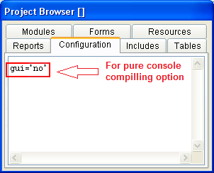

I found the right way for console compiling adding gui='no' at Project Browser/Configuration as follows:
This set at IDE will pass as /c parameter onto Build.bat for console mode compiling which it will be the same for saving at hbc file.
Please note in above picture, the boolean assigning MUST be in quoted. It could be a simple quotes or double quotes but always in quotes. So be careful when your project was made by IDE of HMG 3.0.35 and you will build in the new IDE version. Because hbc files will bring without quotes.

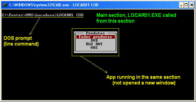

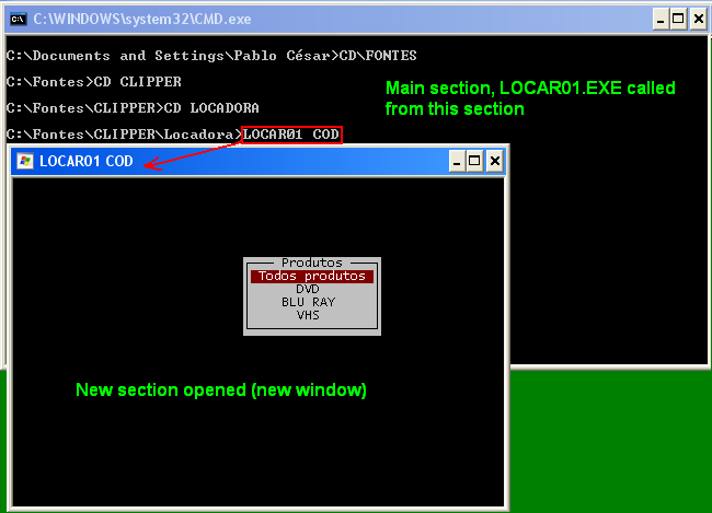

What I tried to explain is when you need only console mode and you wish to avoid in the app creates a new session, like this:
But if you compile with gui='no' option, as I indicated, then it will be create an APP which will preserve same section, like this:
This instructions is when you build/compile your app thru our IDE.
