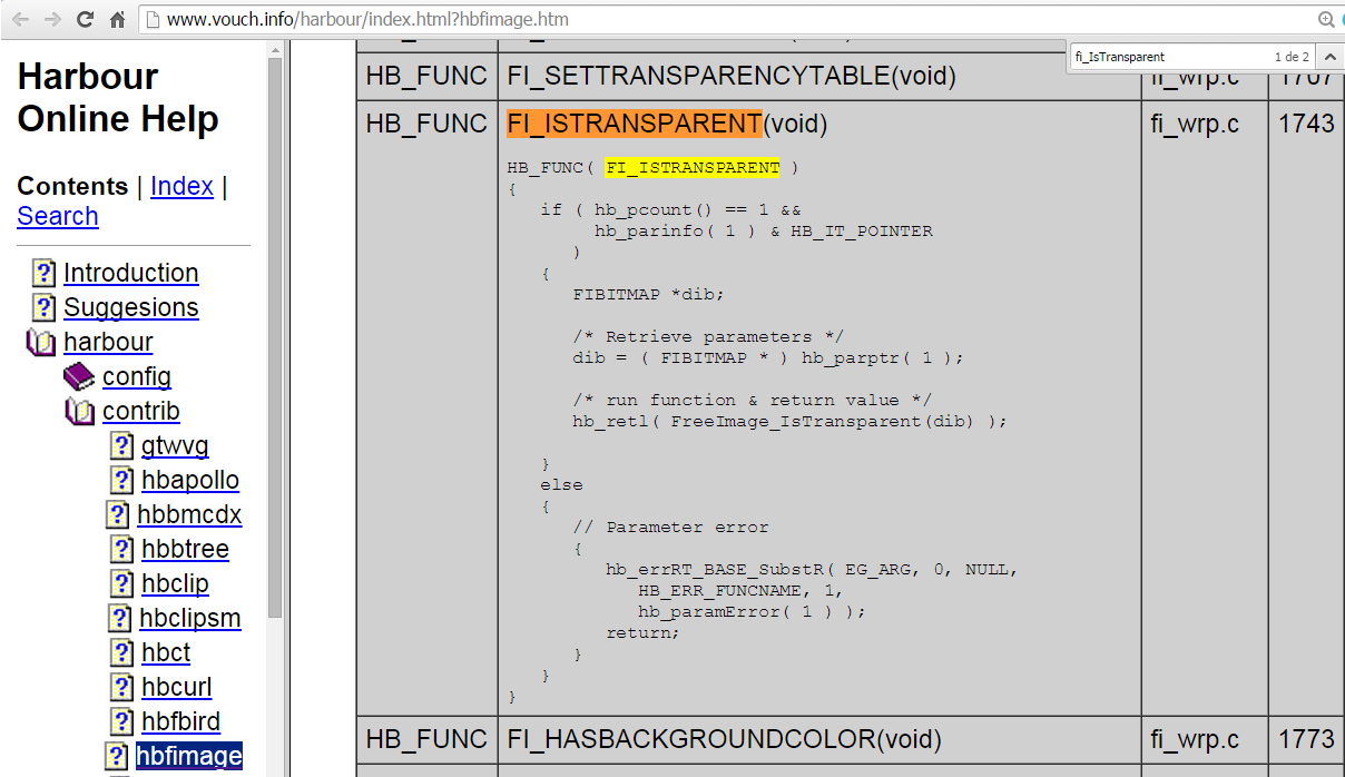

Rathinagiri wrote:I see that only images with color information about transparency are shown in HPDF.
If I enable this while saving the above image in GIMP, the image is shown in the PDF.
Very interesting, thank you Rathi for your tips.
Do you think this could it be warned by previous testing if image file has transparency ?
I saw this fi_IsTransparent function in Harbour:
Probably it could helps if make some enhance in your code or with BosTaurus implementations.

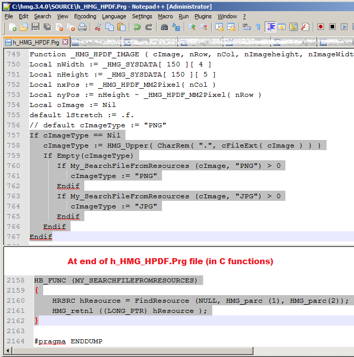

My suggestions to HMG_HPDF
Hi Rathi,
I've got succefully for this case of TYPEs image in h_HMG_HPDF.Prg :D
I've tested and works perfectly with file name without image TYPE at HPDFPRINT IMAGE and also thru resource definition.
// default cImageType := "PNG"
If cImageType == Nil
   cImageType := HMG_Upper( CharRem( ".", cFileExt( cImage ) ) )
   If Empty(cImageType)
      If My_SearchFileFromResources (cImage, "PNG") > 0
	     cImageType := "PNG"
	  Endif
      If My_SearchFileFromResources (cImage, "JPG") > 0
	     cImageType := "JPG"
	  Endif
   Endif
Endif
HB_FUNC (MY_SEARCHFILEFROMRESOURCES)
    HRSRC hResource = FindResource (NULL, HMG_parc (1), HMG_parc(2));
	HMG_retnl ((LONG_PTR) hResource );
I'm sure all of these FindResource, could be optimized for a generic function that it could be by array returning:
  • nHandle
  • cName
  • cType
  • cTrueName
But my C language knowledge is restricted and poor. :|
