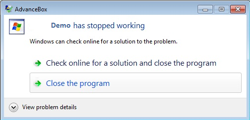

WindowEventCodeBlock
In all my tests when running executable, it's working alternately.
One time is working and in second time not. Subsequently.
Strange behaviour.
Running on Win 7 32 bits in Classic and Aero mode (both with runtime error).

Pablo César wrote:In all my tests when running executable, it's working alternately.
Strange behaviour.
I'm sorry, It is an elementary problem of converting pointers in C
