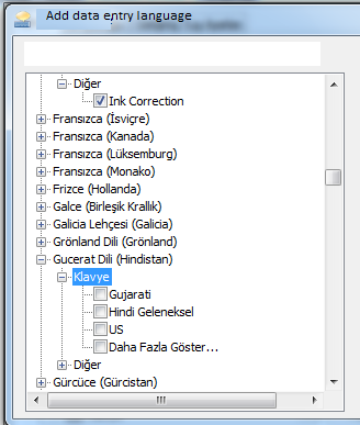

Hi Dave
Are you sure that
- all languages ( defined in aLanguages array ) installed ( by Windows's control panel ) in your system
and
- all language codes (constants) ( again, defined in aLanguages array ) are correct depending on MS definition ?

Re: RICHEDITBOX
esgici wrote: Hi Dave
Are you sure that
and
I have installed Google Input Tools in Hindi, Gujarati Language is working OK
Re: RICHEDITBOX
bpd2000 wrote: I have installed Google Input Tools in Hindi, Gujarati Language is working OK
In Win7 Gujurati exists in control panel\language-keyboard settings
and constant for it defined in MS Language list
I can't say anything for XP, but for Win7 we don't need any other third party tool.
