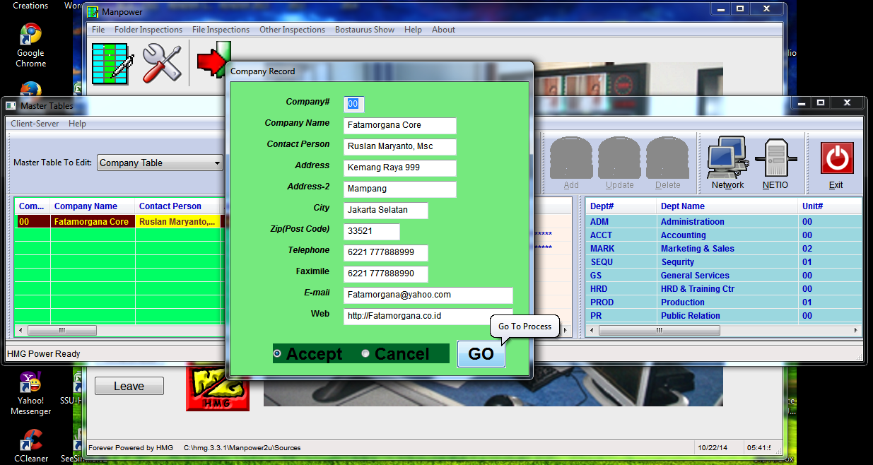

Hi All,
Let me share new development and exercises. Pls note that I decided to MOVE BACKWARD (restart from beginning), in
order to get them better designed. So, managing 3 Master Tables (Company, Unit, Department) must be completed in full control and well designed. Then move to redesign master tables Manpower (Basic, Background, Biodata).
Pls also note this schedule:
..... OCTOBER 2014 - Completion of Master Tables
..... NOVEMBER 2014 - Completion of Payroll Transaction
..... DESEMBER 2014 - Completion of features and options
..... JANUARY 2015 - Ready to fully install & implement
...... FEb 2015..... - Improvement every month to reach maximum quality with HMG
(with bonuses include: Bostaurus, Richedit, ActiveX, important SAMPLES, excellent friend's shares)
Every advice, suggestion, help, comment, (and whatever) is highly appreciated with close attention. I will share newly full-attachment of source-progs when this Master Tables routines are completed and tested; to avoid improper attachment you do not want to see.
Regarding split box as shown before this with 3 Tables in one full window and no space remaining. You may find question; how to do dataentry/display in window, not within grid cell just like MS-Excel? Below screenshoot is the answer. Along with sample codes. Hopefuly, useful for beginners and students (especially in my country Indonesia).
Regards,,,,

***mancomped.fmg*** (sample pieces) Window Template generated with IDE
* HMG-IDE UNICODE Form Designer Generated Code
DEFINE WINDOW TEMPLATE AT 143 , 386 WIDTH 438 HEIGHT 453 VIRTUAL WIDTH Nil VIRTUAL HEIGHT Nil TITLE "Company Record" ICON NIL CHILD
NOMAXIMIZE NOMINIMIZE NOSYSMENU CURSOR NIL ON INIT Nil ON RELEASE Nil ON INTERACTIVECLOSE Nil ON MOUSECLICK Nil ON MOUSEDRAG Nil ON
MOUSEMOVE Nil ON SIZE Nil ON MAXIMIZE Nil ON MINIMIZE Nil ON PAINT Nil BACKCOLOR {142,238,150} NOTIFYICON NIL NOTIFYTOOLTIP NIL ON
NOTIFYCLICK Nil ON GOTFOCUS Nil ON LOSTFOCUS Nil ON SCROLLUP Nil ON SCROLLDOWN Nil ON SCROLLLEFT Nil ON SCROLLRIGHT Nil ON HSCROLLBOX
Nil ON VSCROLLBOX Nil
    DEFINE LABEL Lab_Compcode
        ROW    20
        COL    20
        WIDTH  120
        HEIGHT 24
        VALUE "Company#"
        FONTNAME "Arial"
        FONTSIZE 9
        TOOLTIP ""
        FONTBOLD .T.
        FONTITALIC .T.
        FONTUNDERLINE .F.
        FONTSTRIKEOUT .F.
        HELPID Nil
        VISIBLE .T.
        TRANSPARENT .F.
        ACTION Nil
        AUTOSIZE .F.
        FONTCOLOR NIL
        RIGHTALIGN .T.
    END LABEL

    DEFINE RADIOGROUP Radio_Company
        ROW    370
        COL    60
        WIDTH  250
        HEIGHT 28
        OPTIONS { 'Accept','Cancel'}
        VALUE 1
        FONTNAME "Arial"
        FONTSIZE 18
        TOOLTIP ""
        ONCHANGE Nil
        FONTBOLD .T.
        FONTITALIC .F.
        FONTUNDERLINE .F.
        FONTSTRIKEOUT .F.
        HELPID Nil
        TABSTOP .T.
        VISIBLE .T.
        TRANSPARENT .F.
        SPACING 125
        BACKCOLOR {0,128,64}
        FONTCOLOR {0,0,255}
        READONLY Nil
        HORIZONTAL .T.
    END RADIOGROUP
    DEFINE BUTTON Button_Go
        ROW    365
        COL    320
        WIDTH  70
        HEIGHT 40
        ACTION  ( MancompGetentry(.T.), MancompGetoption(.T.), MancompValidateentry() )
        CAPTION "GO"
        FONTNAME "Arial"
        FONTSIZE 18
        TOOLTIP "Go To Process"
        FONTBOLD .T.
        FONTITALIC .F.
        FONTUNDERLINE .F.
        FONTSTRIKEOUT .F.
        ONGOTFOCUS Nil
        ONLOSTFOCUS Nil
        HELPID Nil
        FLAT .F.
        TABSTOP .T.
        VISIBLE .T.
        TRANSPARENT .T.
        MULTILINE .F.
        PICTURE Nil
        PICTALIGNMENT TOP
    END BUTTON
