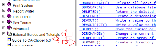

DirMake() is a Clipper 5.3 and Clipper Tools 5.0 function.
There are many places for info :
x-hacker, itlnet, ousob, vivaclipper,vivaclipper, vivaclipper
Addendum :
Shortest Way to DirMake() doc
