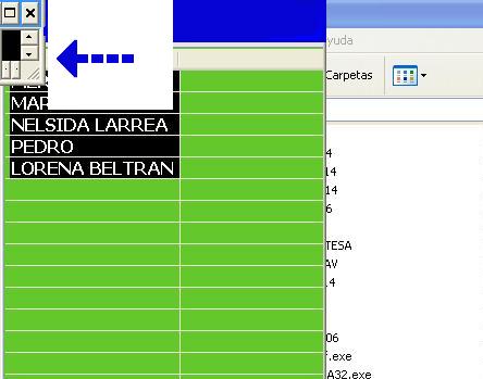

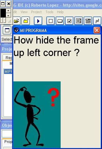

I'm working in console-gui mode yet, when I go of console to gui I declare setmode(1,1), however this frame is keeping in left corner up !
As well as You can disable the X, could You help us also to hide this box with some sentence as hide or release ?

Your example is ok, but the frame is keeping for setmode(1,1) :|
What is sought is that the box (console mode 1,1) disappears or becomes invisible when I go to gui mode 8-)
If this is not possible, then be automatically minimized :?:
Thanks in advance.

That was fantastic !!!
Without the frame of setmode, the program is super cool 8-)
You are so great ... thanks for share ...
