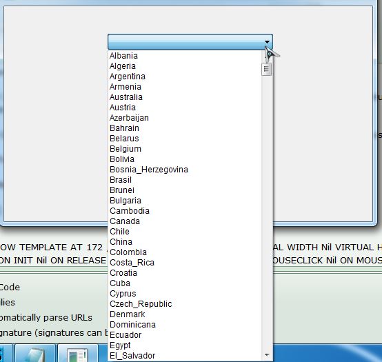

El tratamiento del Form es asi
DEFINE WINDOW TEMPLATE AT 172 , 391 WIDTH 550 HEIGHT 350 VIRTUAL WIDTH Nil VIRTUAL HEIGHT Nil TITLE "" ICON NIL MAIN CURSOR NIL ON INIT Nil ON RELEASE Nil ON INTERACTIVECLOSE Nil ON MOUSECLICK Nil ON MOUSEDRAG Nil ON MOUSEMOVE Nil ON SIZE Nil ON MAXIMIZE Nil ON MINIMIZE Nil ON PAINT Nil BACKCOLOR Nil NOTIFYICON NIL NOTIFYTOOLTIP NIL ON NOTIFYCLICK Nil ON GOTFOCUS Nil ON LOSTFOCUS Nil ON SCROLLUP Nil ON SCROLLDOWN Nil ON SCROLLLEFT Nil ON SCROLLRIGHT Nil ON HSCROLLBOX Nil ON VSCROLLBOX Nil
DEFINE COMBOBOX Combo_1
ROW 40
COL 150
WIDTH 240
HEIGHT 170
ITEMS ChargerItems()
VALUE 0
FONTNAME "Arial"
FONTSIZE 9
TOOLTIP ""
ONCHANGE Nil
ONGOTFOCUS Nil
ONLOSTFOCUS Nil
FONTBOLD .F.
FONTITALIC .F.
FONTUNDERLINE .F.
FONTSTRIKEOUT .F.
HELPID Nil
TABSTOP .T.
VISIBLE .T.
SORT .F.
ONENTER Nil
ONDISPLAYCHANGE Nil
DISPLAYEDIT .F.
IMAGE Nil
DROPPEDWIDTH Nil
ONDROPDOWN Nil
ONCLOSEUP Nil
END COMBOBOX
