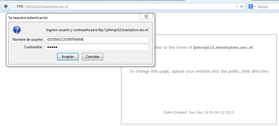

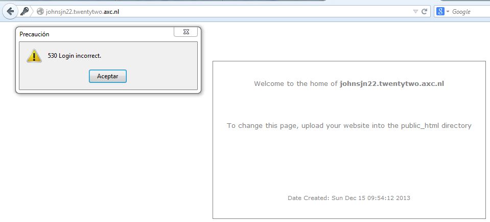

Hi
And sorry, the GOODACCOUNTNAME and NOTGOODACCOUNTNAME was only ment to make a statement
ftp://Eldemo@johnsjn22.twentytwo.axc.nl ... two.axc.nl
working in Chrome 34.0.1847.137 m
not working in IE 11
( can someone please confirm ? )
so also some browsers have problem with the @ i think
attach screenshot ftp

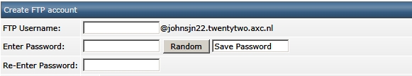

as you can see very simple,
only thing is,
@johnsjn22.twentytwo.axc.nl is forced as part of the username
Thanks and greetings...
