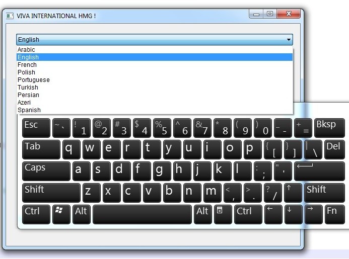

srvet_claudio wrote: ...
is this what you wanted ?
Frankly no :)
I did not think it would be so good :o
Perfect 8-) ( as always )
Thank you very much doc :D
PROCEDURE Main
   aLanguages := { { 'Arabic',     0x0401 },;
                   { 'English',    0x0409 },;
                   { 'French',     0x040C },;
                   { 'Polish',     0x0415 },;
                   { 'Portuguese', 0x0416 },;
                   { 'Turkish',    0x041F },;
                   { 'Persian',    0x0429 },;
                   { 'Azeri',      0x042C },;
                   { 'Spanish',    0x040A } }
   aLangNames := {}
   aLangCodes := {}
   AEVAL( aLanguages, { | a1 | AADD( aLangNames, a1[ 1 ] ), AADD( aLangCodes, a1[ 2 ] ) } )
   cCurr_KLName := GetKeyboardLayoutName()
   nCurr_KLNo := CTON( cCurr_KLName, 16 )
   nInsKLNo := ASCAN( aLangCodes, nCurr_KLNo )  // Installed KBL no
   DEFINE WINDOW Form_Main ;
      WIDTH 600 HEIGHT 480 ;
      MAIN ;
      TITLE "VIVA INTERNATIONAL HMG !"
      @ 50, 20 EDITBOX editbox_1 WIDTH 550 HEIGHT 350 VALUE ""
      @ 20, 20 COMBOBOX cmbLangs WIDTH 550 HEIGHT 350 ITEMS aLangNames ON CHANGE ChangeUILang( This.Value ) VALUE nInsKLNo
   CENTER WINDOW Form_Main
   ACTIVATE WINDOW Form_Main

UI_Lang Select screen shoot
