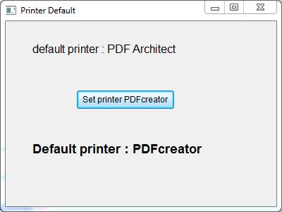

Re: PrintWindow
Sorry . Update Sample
#require "hbwin"
Function main
Public cPrinter:= GetDefaultPrinter()
DEFINE WINDOW Main AT 160 , 314 WIDTH 400 HEIGHT 300 Main TITLE 'Printer Default'
    DEFINE LABEL Label_1
        ROW    30
        COL    38
        WIDTH  250
        HEIGHT 24
        VALUE "default printer : " + cPrinter
        FONTNAME "Arial"
        FONTSIZE 12
        TOOLTIP ""
        END LABEL
	 DEFINE BUTTON Button_1
        ROW    97
        COL    100
        WIDTH  140
        HEIGHT 28
        ACTION Prn()
        CAPTION "Set printer PDFcreator"
    END BUTTON
    DEFINE LABEL Label_2
        ROW    170
        COL    38
        WIDTH  300
        HEIGHT 24
		VALUE ""
        FONTNAME "Arial"
        FONTSIZE 14
       FONTBOLD .T.
    END LABEL
Main.Center
Main.Activate
Function Prn()
win_printerSetDefault( "PDFcreator" )
cPrinter  := "Default printer : " + GetDefaultPrinter()
Main.Label_2.Visible := .T.
Main.Label_2.Value := cPrinter
Main.Label_2.Refresh
2014-04-15 11_45_17-Printer Default.jpg (15.14 KiB) Viewed 4600 times

Re: PrintWindow
Post by Agustin »
Ahora si funciona bien.
Muy agradecido.
