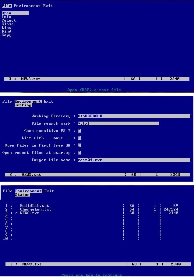

A simple text file processing sample by Harbour's HB_F* functions
Another work to explore Harbour !
HB_F* functions are denoted as "nanforum ft_f*() clones" in the changelog.txt of Harbour at 19990528 :
+ source/tools/hb_f.c
  • - hb_fuse
    - hb_frecno
    - hb_flastrec
    - hb_fgotop
    - hb_fgobottom
    - hb_fgoto
    - hb_feof
    - hb_freadln
    - hb_fselect
    - hb_fskip
Purpose of this work is simply build a general acknowledge about these funtions.
Since subject is only Harbour, used pure-console mode for simplicity and GUI concepts not used.
Look at here for documentation on this and some other text file processing functions.
TFP tests screen shoots
TFP_Tests.zip
TFP tests source files
(6.86 KiB) Downloaded 358 times
