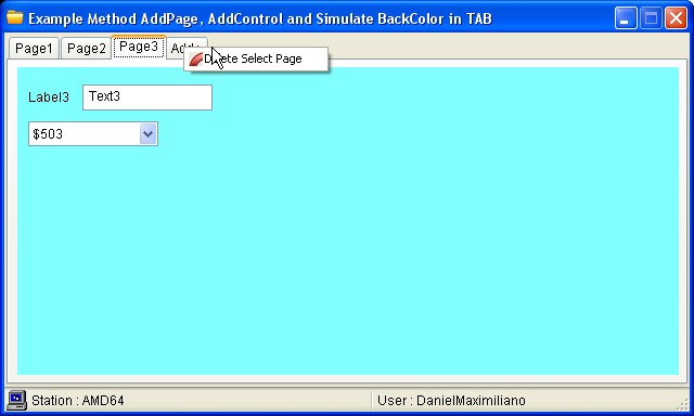

I would eliminate the Toolbar completely and recreate the necessary buttons.
this is an example to create and delete controls inside a form I made a while
Public nPage        := 0
Public cPage         := "Page"  + ltrim(str(nPage))
Public cText         := "Text"  + ltrim(str(nPage))
Public cImage        := "Image" + ltrim(str(nPage))
Public cLabel        := "Label" + ltrim(str(nPage))
Public cCombo        := "Combo" + ltrim(str(nPage))
Procedure DeletePage()
Local nDelete
nDelete:= Principal.Container_Tab.Value
cImage := "Image" + ltrim(str(nDelete))
cLabel := "Label" + ltrim(str(nDelete))
cText  := "Text"  + ltrim(str(nDelete))
cCombo := "Combo" + ltrim(str(nDelete))
if iscontroldefined(&cImage,Principal)
   Principal.&(cLabel).RELEASE
   Principal.&(cImage).RELEASE
   Principal.&(cText).RELEASE
   Principal.&(cCombo).RELEASE
     Principal.Container_Tab.DELETEPAGE(nDelete)
   nPage--
   IF nPage == 1
      AddNewPage()
   MSGINFO("Cannot delete PAGE Add+","   Info  " )
Function AddNewPage()
IF nPage == 1
   cPage := 'Page'+ltrim(str(nPage))
   Principal.Container_Tab.AddPage ( nPage, cPage )
   AddControls()
   nPage++
   Principal.Container_Tab.Value  := nPage - 1
 IF Principal.Container_Tab.Value == nPage
    IF nPage >= 2
        Principal.Container_Tab.DeletePage(nPage)
        AddControls()
        nPage++
        Principal.Container_Tab.AddPage ( nPage, 'Add+','New.jpg' )
            nPage++
            AddControls()
            nPage++
            Principal.Container_Tab.AddPage ( nPage, 'Add+' )
            Principal.Container_Tab.Value  := 1
