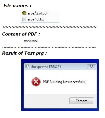

Results of this SSW
Results of this SSW
the code :
  Exploring UTF8 implementation in HMG_HPDF
#include "hfcl.ch"
PROCEDURE Main()
   cSourceFileName := "español.txt"
   cSourceText := HB_MEMOREAD( cSourceFileName )
   cTargetFileName := STRTRAN( cSourceFileName, "txt", "pdf" )
   SELECT HPDFDOC ( cTargetFileName ) TO lSelPDF // papersize HPDF_PAPER_A4
   IF lSelPDF
      START HPDFDOC
         START HPDFPAGE
            @ 20,  20 HPDFPRINT cSourceText
         END HPDFPAGE
      END HPDFDOC
      IF FILE( cTargetFileName )
         MsgInfo( "PDF Builded as " + cTargetFileName )
         MsgStop( "PDF Building Unsuccessful :(", "Unexpected ERROR !" )
      ENDIF FILE( cTargetFileName )
   ENDIF lSelPDF
RETURN // BTExplore.Main()
*-._.-._.-._.-._.-._.-._.-._.-._.-._.-._.-._.-._.-._.-._.-._.-._.-._.
Any idea :?:

Re: Unicode and HMG_HPDF
Esgici,
As of now we can't use unicode with HPDF.
Claudio had also tested in a newer version of HPDF for unicode. We are investigating this and it is a main agenda for the upcoming versions.
Post by IMATECH »
Hi Esgici !
Adjusted ( but not tested ! )
#include "hfcl.ch"
PROCEDURE Main()
   cSourceText := hb_Translate( HB_MEMOREAD( cSourceFileName ), 'UTF8EX', 'ESISO' )
   SELECT HPDFDOC ( hb_Translate( cTargetFileName, 'UTF8EX', 'ESISO' ) ) TO lSelPDF // papersize HPDF_PAPER_A4
   IF lSelPDF
      _HMG_HPDF_SetEncoding( "WinAnsiEncoding" )
      START HPDFDOC
         START HPDFPAGE
         END HPDFPAGE
      END HPDFDOC
   ENDIF lSelPDF
