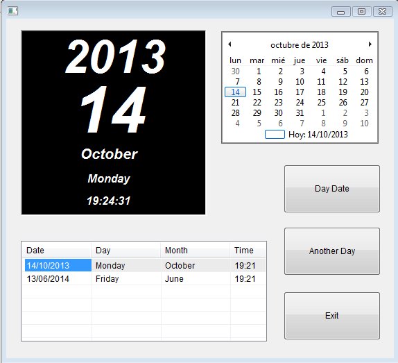

Hola gabrieloq
Te dejo un sample que en su dia formaba parte de
un programa que publique:
viewtopic.php?f=9&t=1059" onclick="window.open(this.href);return false;" onclick="window.open(this.href);return false;
Haber si te puede servir, te dejo los samples
en ingles y español.
sample_En.prg y sample_Es.prg
tienes que compilar con HMG 3.1.5
Hello gabrieloq
I leave a sample that once was part of
a program to publis:
Have if you can help, I'll let the samples
in English and Spanish
sample_En.prg and sample_Es.prg
HMG have to compile with 3.1.5
Sample_Calendar.zip
(42.47 KiB) Downloaded 256 times

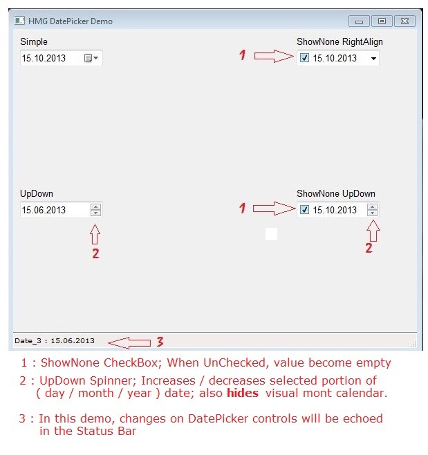

Some details on DATEPICKER control
Hi All
Made some little modifications on DatePicker control demo, for emphasize some handy details of this control.
Some details on DatePicker control
 * Copyright 2002 Roberto Lopez <mail.box.hmg@gmail.com>
 * http://www.hmgforum.com//
 * Sligtly modified version of DatePicker demo.
   SET DATE GERM
   SET CENT ON
	DEFINE WINDOW Form_1 ;
		WIDTH 600 HEIGHT 500 ;
		TITLE "HMG DatePicker Demo" ;
		MAIN ;
		FONT "Arial" SIZE 10
		@ 10,10 LABEL Label_1 VALUE "Simple"
		@ 30,10 DATEPICKER Date_1 ;
      VALUE DATE() ;
		TOOLTIP "DatePicker Control";
      ON CHANGE UpdaSBar()
		@ 10,410 LABEL Label_2 WIDTH 200 VALUE "ShowNone RightAlign"
		@ 30,410 DATEPICKER Date_2 ;
      VALUE DATE() ;
		TOOLTIP "DatePicker Control ShowNone RightAlign" ;
		SHOWNONE ;
		RIGHTALIGN;
		@ 230,10 LABEL Label_3 WIDTH 200 VALUE "UpDown"
		@ 250,10 DATEPICKER Date_3 ;
      VALUE DATE() ;
		TOOLTIP "DatePicker Control UpDown" ;
		UPDOWN;
		@ 230,410 LABEL Label_4 WIDTH 200 VALUE "ShowNone UpDown"
		@ 250,410 DATEPICKER Date_4 ;
      VALUE DATE() ;
		TOOLTIP "DatePicker Control ShowNone UpDown" ;
		SHOWNONE ;
		UPDOWN;
      DEFINE STATUSBAR FONT 'Verdana' SIZE 8
          STATUSITEM ""
      END STATUSBAR
	CENTER WINDOW Form_1
	ACTIVATE WINDOW Form_1
PROCEDURE UpdaSBar()
   Form_1.StatusBar.Item(1) :=  This.Name + " : " + DTOC( This.Value )
RETURN // UpdaSBar()
