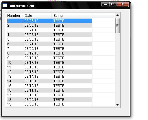

Hi Amarante:
No there are not other upgrades.-
I've attached the screen to show you it functions ok.-
- grid_demo_screen.JPG (36.27 KiB) Viewed 30957 times
