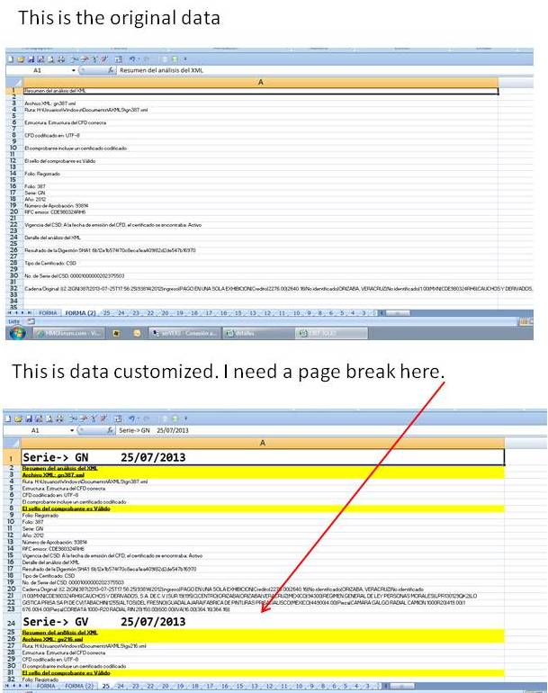

I did make an application that creates an Excel Spreadsheet and contains data from row1 to rowN in column A.
This data are not the same type, then when i want to print i need to separate this data in groups.
If one of those groups has only 20 rows, i need in one page those 20 rows.
I explain it right?
calscot:
yes, i did a macro, but the instruction "oExcel:WorkSheets(3):cells(ifila3,ncol):HPageBreaks:Add()" does not work.
some idea?
thanks.
"line jump" mmm.....
dany:
I explain it right?
calscot:
some idea?
thanks.

Re: Insertar salto de linea en Excel / Excel line jump
I´ve been seeking, but nothing.
