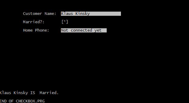

My goal was seeing some features exist only C53, like @ ... GET CHECKBOX in text box.
it really work :o :
Checkbox in text mode
and the source code :
STORE SPACE (25) TO Name
STORE .T. TO Married
STORE SPACE (19) TO Phone
CLS
@  5,10 SAY "Customer Name: " GET Name
@  7,10 SAY "Married?:      " GET Married CHECKBOX
@  9,10 SAY "Home Phone:    " GET Phone
READ
? ALLTRIM (Name) + " IS " + IIF(Married,"","NOT") + " Married."
WAIT "END OF CHECKBOX.PRG"
Quite impressive, is not it ?
