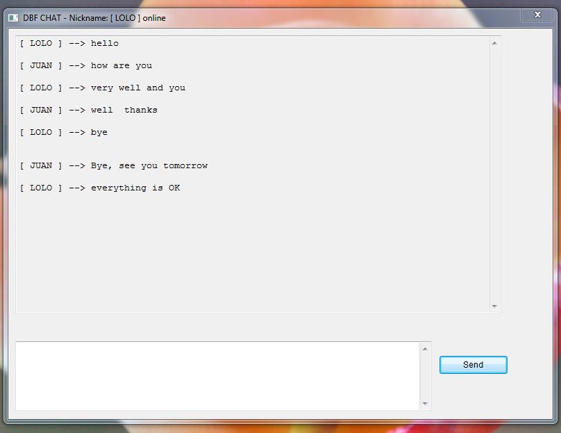

srvet_claudio wrote: This is an example of a chat with DBF.
Open multiple copies of the program and register with differents nicknames.

DBF Chat Screen Shoot
DBF Chat Screen Shoot.JPG (47.58 KiB) Viewed 10339 times
Re: implementar un Chat
