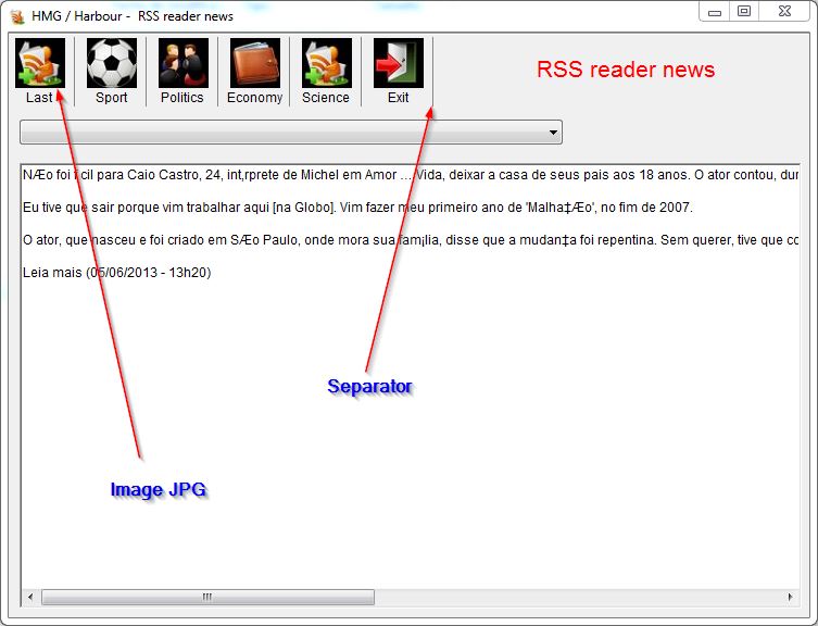

HMG 3.1.3 (Test) - ToolBar
Claudio, usé HMG.3.1.3 el IDE estandard para crear el Formulario que despues modifique a mano, modifique
C:\hmg.3.1.3\INCLUDE\SET_COMPILE_HMG_UNICODE.ch
 HMG Header File --> SET_COMPILE_HMG_UNICODE.ch
 Copyright 2012 by Dr. Claudio Soto (from Uruguay).
 mail: <srvet@adinet.com.uy>
 blog: http://srvet.blogspot.com
 Permission to use, copy, modify, distribute and sell this software
 and its documentation for any purpose is hereby granted without fee,
 provided that the above copyright notice appear in all copies and
 that both that copyright notice and this permission notice appear
 in supporting documentation.
 It is provided "as is" without express or implied warranty.
   If defined       COMPILE_HMG_UNICODE   --->  The HMG library is built to support the ANSI and UNICODE character set.
   If NOT defined   COMPILE_HMG_UNICODE   --->  The HMG library is built to support ONLY the ANSI character set.
 #define COMPILE_HMG_UNICODE */
Reconstruí la libhmg.a y veo que el Toolbar no presenta el marco de los botones.
Es algo que ignoré o hice mal en el codigo ????
Claudio, I used HMG.3.1.3 the standard IDE to create the form which I had modified manually. What I have changed at
C: \ hmg.3.1.3 \ INCLUDE \ SET_COMPILE_HMG_UNICODE.ch
I rebuilt the libhmg.ay see that no part of Toolbar buttons.
It's something that I ignored or did wrong in the code????

Please Daniel, post a screenshot pointing out the error and windows version.
Re: HMG 3.1.3 (Test)
aqui esta la imagen Claudio.
RSS reader news.jpg (57.8 KiB) Viewed 33656 times
el codigo fuente esta en el topico : http://hmgforum.com/viewtopic.php?f=5&t=2983
danielmaximiliano wrote:aqui esta la imagen Claudio.
Hi Daniel,
Apparently is a normal behavior of Win7, I compiled with HMG.3.0.46 and see equal.
Saludos,
Claudio
