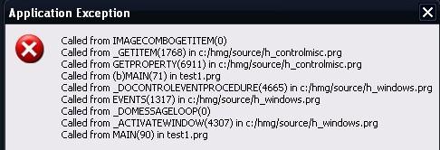

We have a problem on C:\hmg\SAMPLES\COMBO_5\test1.prg :(
When choosing "Get Item" from menu it has been crashed and caused too crashing of drwatson32.exe of Windows :?
Win XP SP2; HMG 2.8.8.
Problem in Combo Sample 5

I've found a very interesting thing.
The image combo was introduced in 2.5.5 and item property read worked ONLY in that version.
From 2.5.6 to now it generates a GPF.
The 2.5.5 is bundled with Harbour 1.0 RC2.
The 2.5.6 is bundled with Harbour 1.0 Final (newer versions with 1.01).
If you install any newer HMG version and replaces Harbour compiler with 1.0 RC2 it will work fine (yet 2.8.8).
So, I must find another way to do the same (read image combo item) without 'obfuscate' Harbour (it will not be easy).

I've fixed.
Please, replace the function 'ImageComboGetItem' in 'c_combo.c' with this:
HB_FUNC( IMAGECOMBOGETITEM )
	char text [1024] ;
	COMBOBOXEXITEM cbei;
	cbei.mask = CBEIF_TEXT | CBEIF_SELECTEDIMAGE | CBEIF_IMAGE;
        cbei.iItem          = hb_parni(2)-1;
        cbei.pszText        = text;
        cbei.cchTextMax     = 255;
	cbei.iImage         = 0;
	cbei.iSelectedImage = 0;
	SendMessage( (HWND) hb_parnl(1) , CBEM_GETITEM , 0 , &cbei ) ;
	hb_reta (2) ;
	hb_storni ( cbei.iImage , -1 , 1 ) ;
	hb_storc ( cbei.pszText  , -1 , 2 ) ;
Roberto.

Hi
Applied and tested.
After replacing Harbour 1.0.0 with 1.0 RC2 under HMG 2.8.8 worked fine :)
After rollbacked Harbour and replacing IMAGECOMBOGETITEM function in 'c_combo.c' also worked fine :D
Thanks a lot Le Roy :D
