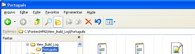

I have compiled a HMG project in one determined folder and every was ok. But after change folder name with portuguese accents in the name folder, had started to malfunction (not start app), knowing that app was working properly.
The rest of error message is: "C:\Fontes\HMG\View_Build_Log\Português\View_Build_Log.exe" so I noticed something was with OS and I had changed again the sub-folder name for Portuguese instead Português (with brazilian accents)
, then it started to work properly again.
