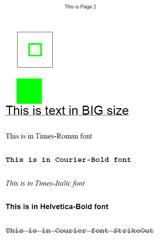

Can you achieve font underline, strike out effects in PDF?

rathinagiri wrote:That is a great news.
Hi Rathi,
It is possible with a small trick below:
      if lStrikeout .or. lUnderline
         HPDF_Page_SetLineWidth( _HMG_HPDFDATA[ 1 ][ 7 ], 1 )
         if lColor
            HPDF_Page_SetRGBStroke( _HMG_HPDFDATA[ 1 ][ 7 ], nRColor/255, nGColor/255, nBColor/255 )
            HPDF_Page_SetRGBStroke( _HMG_HPDFDATA[ 1 ][ 7 ], 0.0, 0.0, 0.0 )
         nyPos += IF( lUnderline, -1, _HMG_HPDF_Pixel2MM(nFontSize)/2+1 )
         HPDF_Page_MoveTo( _HMG_HPDFDATA[ 1 ][ 7 ], nxPos, nyPos )
         HPDF_Page_LineTo( _HMG_HPDFDATA[ 1 ][ 7 ], nxPos + nTextWidth, nyPos )
         HPDF_Page_Stroke( _HMG_HPDFDATA[ 1 ][ 7 ] )
Sample Page with underline and strike out effects
