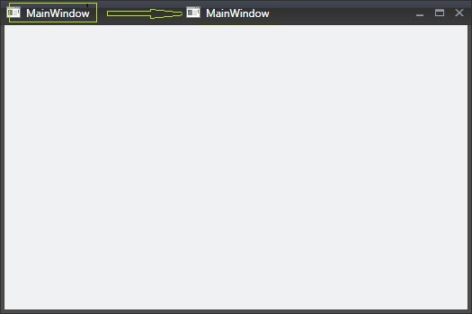

How do I make the Window's Title align in “Center” not in “Left”.
How do I change the window's title alignment to center ? Like this:
I have tried to set Window's font to Courier New which is monospaced (fixed-width) but for title is not working.

Pablo César wrote: How do I change the window's title alignment to center ?
Hello Pablo,
Please be so kind to try the following simple sample:

Hope that helps :idea:
Window's Title to Center
Wow Master ! Thank you for your indications, Mr. Grigory. It is almost quite 100% OK, but in order to avoid "..." as part of title shown, I have make some changings. Probably it is for my Windows is not main Window. Ssorry I have mentioned as main but in real is MODAL and with NOSIZE and NOSYSMENU. So I subtract -70 (wich is not exact value) but it approximally center aligned.
