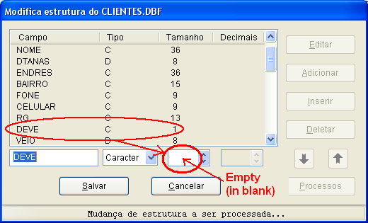

I found a weird behaviour (ie a BUG) when double clicked or editing at field with caracter-type and lengh 1. In first editing spinner_1 is showing in blank not like as 1. But if cancel and returning editing then spinner_1 is showing 1. I tried to refresh spinner but it doesn´t work. Very strange. My tries was at line 1530 of attached Stru.prg file, unsuccefully. :cry:
In the first time I went in to edit, it does not shows the value "1" in Spinner_1:
When is canceled editing and returns for the second time, then yes it appears correctly:
Very strange! :(
