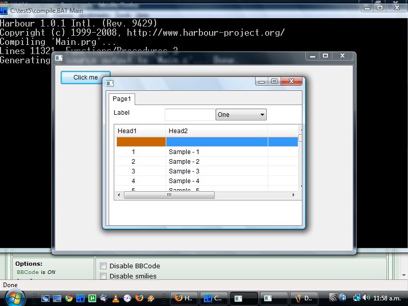

rathinagiri wrote: 4. When one column is having 0 width navigation cursor is not seen. (May be this is not a bug. But the user doesn't know about the column. ;))
I am attaching a sample with child window.
The attachment gridsample.zip is no longer available
I would come with screenshots soon.
[/quote]
Maybe this is not a bug. You've not assigned a value to the grid, so no row is highlighted.
If you add the following line prior window activation:
sample.g1.value := 1
The first line will be show.
Roberto.

No, I think I had not put the situation correctly. If we make the width of a column as 0, say like this 'widths {100,100,0,100}', then the cursor is not shown if the cell is moved through that column. Actually it is not a bug. But, the user doesn't know about the column at all. Sometimes, it is useful to hide some information (like recno) which is not useful to the user, but could be useful for the programmer.
Re: Harbour MiniGUI 2.8.0
rathinagiri wrote: If we make the width of a column as 0, say like this 'widths {100,100,0,100}', then the cursor is not shown if the cell is moved through that column. Actually it is not a bug. But, the user doesn't know about the column at all. Sometimes, it is useful to hide some information (like recno) which is not useful to the user, but could be useful for the programmer.
Well... perhaps the cursor update routine should skip the column if its width is zero.
I'm focused in the 'big' bugs now (those related with app stability). When this work be finished, I'll work on 'fine-tune'.
