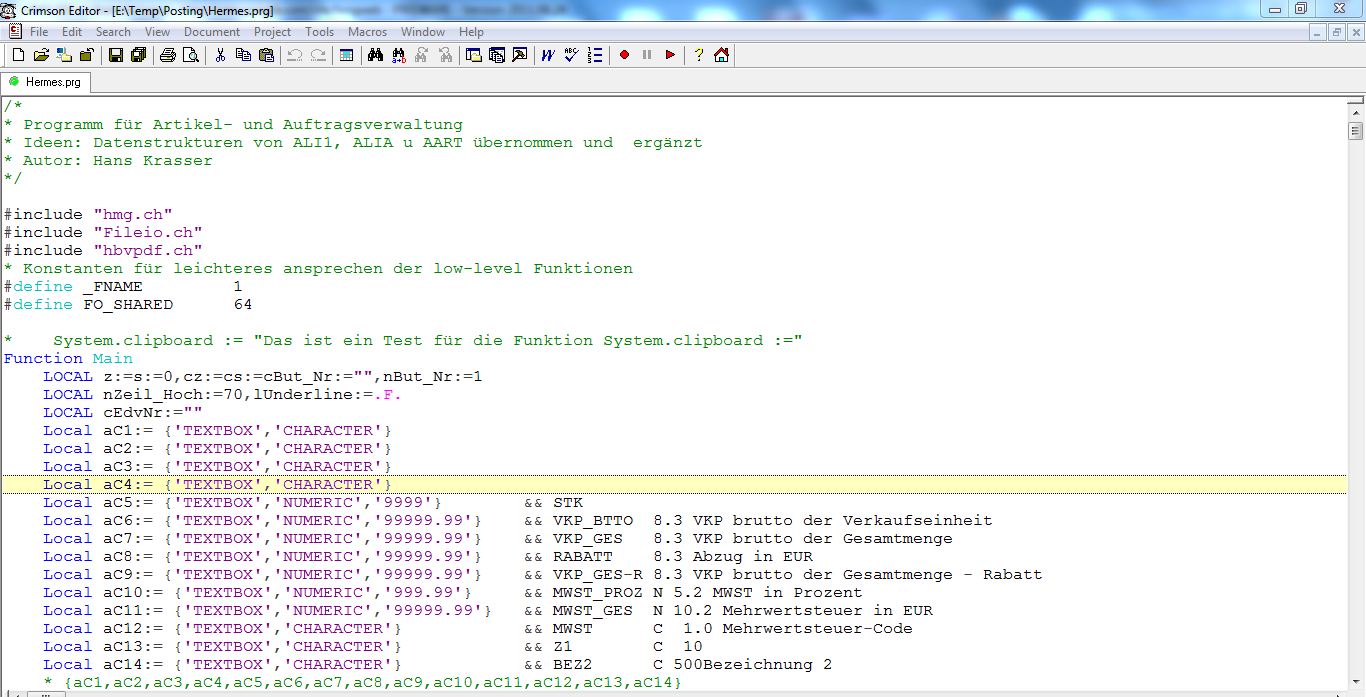

Sorry I forgot to comment on the changes the source file
Crimson Editor - [ETempPostingHermes.jpg (168.33 KiB) Viewed 7384 times

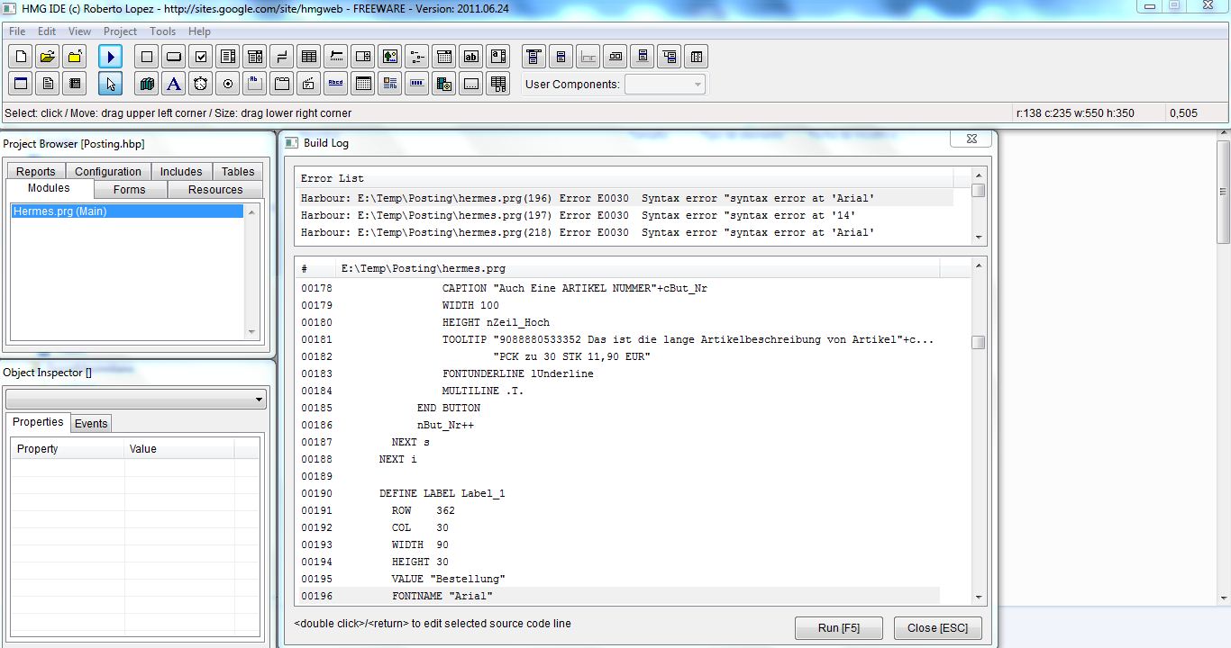

Unfortunately there are new problems - ev. because of name-conflicts in hbvpdf.ch and forms (fmg)
Begin of hbvpdf.ch
* $Id: hbvpdf.ch 11685 2009-07-09 21:22:22Z vszakats $
#include "fileio.ch"
#include "common.ch"
#define CRLF chr(13)+chr(10)
#define NORMAL 0
#define BOLD 1
#define ITALIC 2
#define BOLDITALIC 3
After including hbvpdf.ch:
............................... (only some examples:) .............
.\PLMED_AART.fmg(1529) Error E0030 Syntax error "syntax error at '12'"
.\PLMED_VKP.fmg(13) Error E0030 Syntax error "syntax error at 'Arial'"
.\PLMED_VKP.fmg(14) Error E0030 Syntax error "syntax error at '12'"
.\PLMED_VKP.fmg(38) Error E0030 Syntax error "syntax error at 'Arial'"
.\PLMED_VKP.fmg(39) Error E0030 Syntax error "syntax error at '12'"
.\PLMED_VKP.fmg(63) Error E0030 Syntax error "syntax error at 'Arial'"
.\PLMED_VKP.fmg(64) Error E0030 Syntax error "syntax error at '12'"
.\PLMED_VKP.fmg(88) Error E0030 Syntax error "syntax error at 'Arial'"
.\PLMED_VKP.fmg(89) Error E0030 Syntax error "syntax error at '12'"
.\PLMED_VKP.fmg(113) Error E0030 Syntax error "syntax error at 'Arial'"
.\PLMED_VKP.fmg(114) Error E0030 Syntax error "syntax error at '16'"
.\PLMED_VKP.fmg(139) Error E0030 Syntax error "syntax error at 'Arial'"
.\PLMED_VKP.fmg(140) Error E0030 Syntax error "syntax error at '12'"
545 errors
No code generated.
hbmk2: Error: Running Harbour compiler (embedded). 1
(c:\hmg.3.0.41\harbour\bin\harbour.exe) -n2 hermes.prg -q -oC:\DOKUME~1\Hans\LOKALE~1\Temp\hbmk_xywwws.dir\ -ic:\hmg.3.0.41\harbour\include -i. -ic:\hmg.3.0.41\include

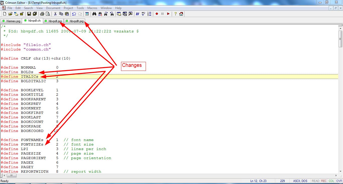

changes in Hermes.prg
* Programm für Artikel- und Auftragsverwaltung
* Ideen: Datenstrukturen von ALI1, ALIA u AART übernommen und  ergänzt
* Autor: Hans Krasser

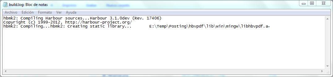

Include new Lib in x:\Temp\Posting\hbvpdf\lib\win\mingw To C:\hmg.3.0.41\LIB
build lib.jpg (36.05 KiB) Viewed 7319 times
changes were made to avoid conflicts with repeated variables
Crimson Editor - [ETempPostinghbvpdf.jpg (131.77 KiB) Viewed 7319 times
ud have corrected their application as HMG project, you can compile using the IDE or simply drag and drop on mibuild.bat
