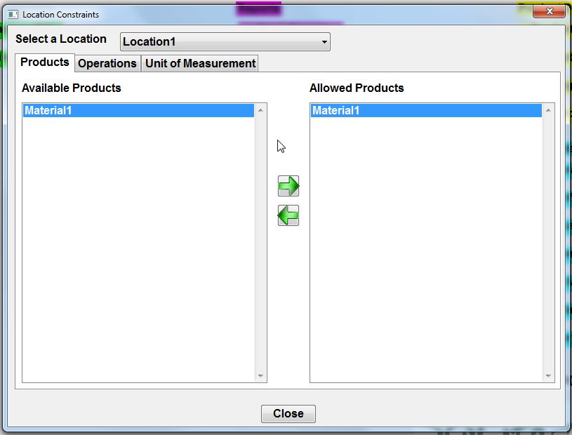

1. We have to allow the material in the location. This is the first tab. Left side you have a list of all available products, and in the right side you have allowed materials in location. We can remove or add by pressing the arrow buttons.

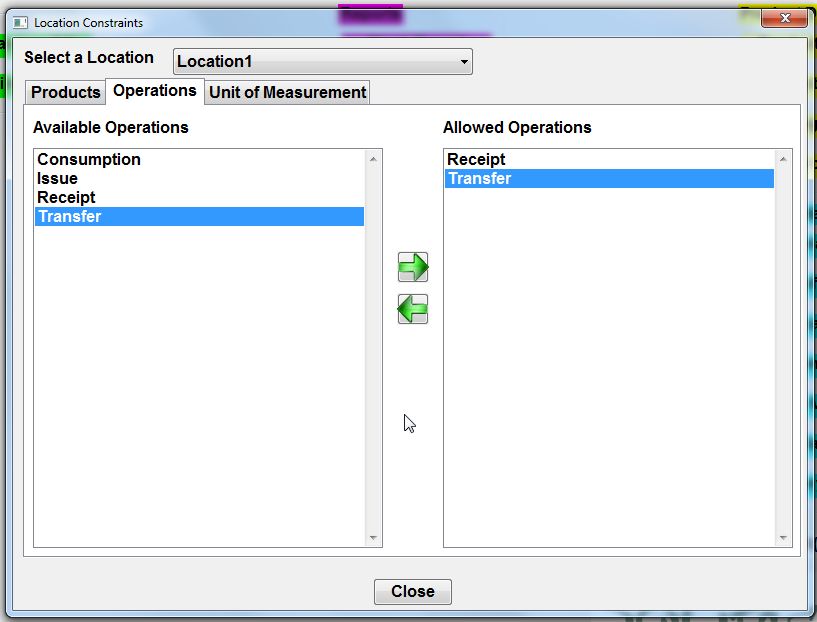

2. We have to allow some operations in the location. It is done in the second tab. You can add the operations allowed for this location. For example, we are allowing only receipt and transfer operations for this location.

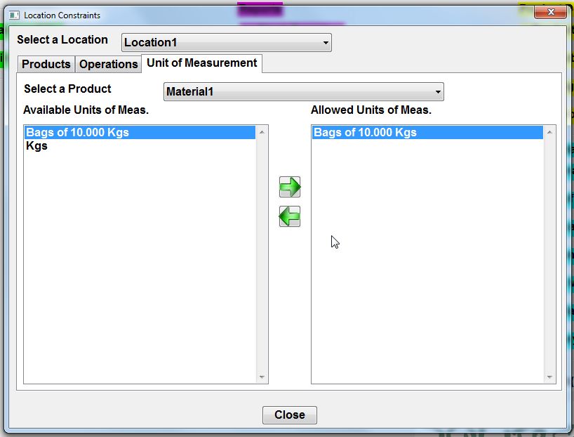

3. The third and final is for defining the Unit of Measurement for the material in the particular location. Now we are allowing only 'Bags of 10 Kgs' in this location. :)
Now, we can enter only 'Bags of 10 kgs' of 'Materia 1' to be received or transferred in location 1. We have to configure like this whenever we want to add some materials to the locations.
