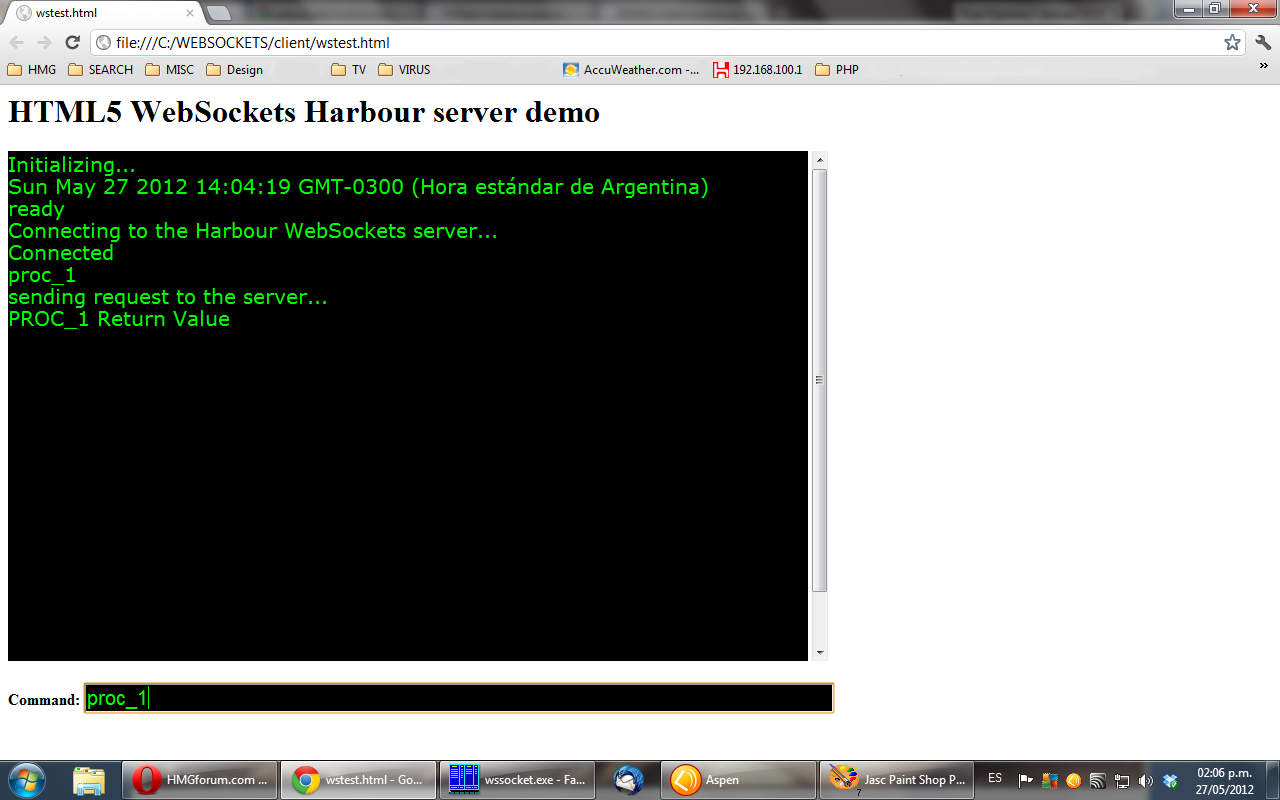

This basically means that if you send the messages 'PROC_1' or 'PROC_2' from your web client to the server, the required code will be executed for each one.
The client HTML file, has a command line and a window to show the server's answers.
The only thing you must to do, is to write the adecuate message and press <ENTER>.
You simply must to unzip the attached file, execute 'wssocket.exe' and then open wstest.html with you web browser.
It looks as follows:
This is a basic proof of concept. I'll describe the complete path in another (and final) post.
