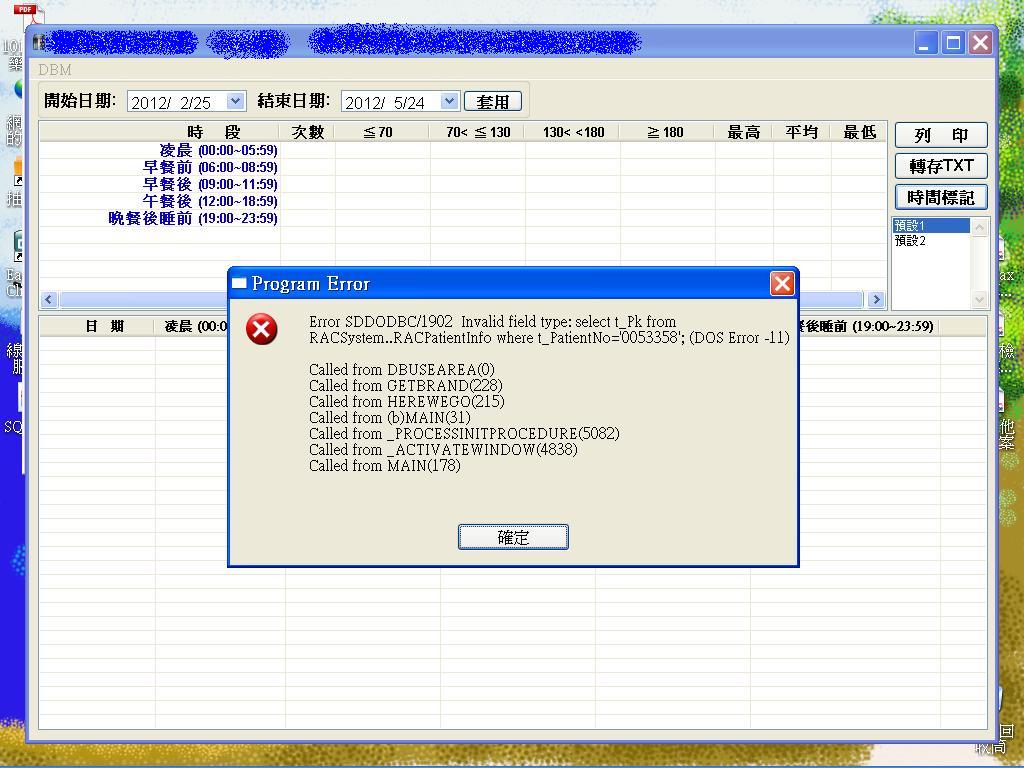

Today I encounter a big problem while query data from fields which is uniqueidentifier data type.
The DOS error message display while I execute application, which as attachment.
Following are partial source code:
227:m_sqlLogin:='select t_Pk from RACSystem..RACPatientInfo where t_PatientNo='+"'"+m_s1+"'"+';'
228:DBUSEAREA(.T.,,m_SQLLogin, "TEMPDBF1" )
The field 『t_Pk』is uniqueidentifier data type.
Please Help!
Best Regards
chen min

I have been try before about 1 dot. It have to be 2 dot.
DBF take SQL uniqueidentifier as hexadecimal type and fail to deal with it.
I also tried to add SQL function 'CAST' or 'CONVERT' to m_SQLLOGIN. It also fails.
Best Regards
chen min

My problem had been solved!
You wouldn't believe how simple it is.
m_sqlLogin:='select CAST(t_Pk AS varchar(36)) AS DDAA from RACSystem..RACPatientInfo where t_PatientNo='+"'"+m_s1+"'"+';'
CAST(t_Pk AS varchar(36)) convert uniqueidentifier to varchar with length of 36 byte.
『AS』followed function CAST must have. It refer to a new title for query result that DBF could recognize.
Best Regards
chen min
