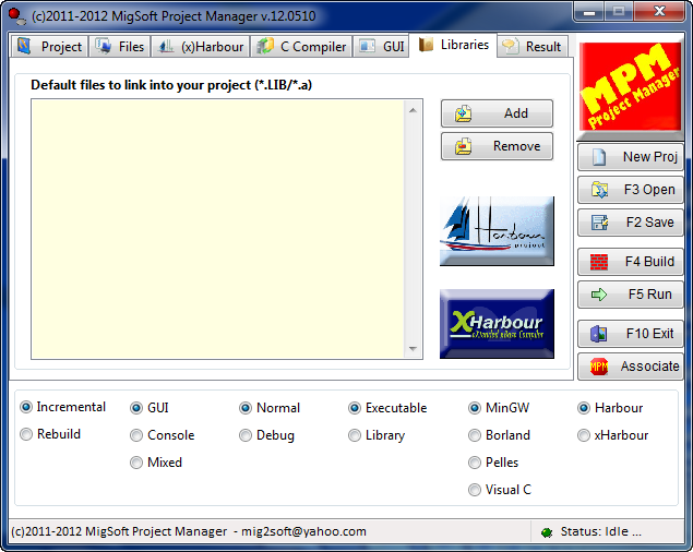

Hi All,
MPM New release
MPM New release
- mpm+.zip
- (955.56 KiB) Downloaded 555 times
- 2012-05-12_104450.png (85.02 KiB) Viewed 6709 times

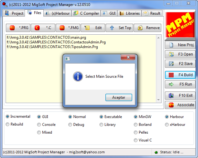

I'm trying to use MPM but I get the following error:
"Select Main Source File"
HMG is all ok with no errors
Why?
Brunello
Why?
Brunello

In file "Readme.txt": The resource file ".RC" must have the same file name ".PRG" selected as the top.
In the example shown in the picture, the solution is to rename the file "contactos.rc" with "main.rc" or otherwise change the name of "Main.prg" with "contactos.prg"
I remove this limitation in later versions
