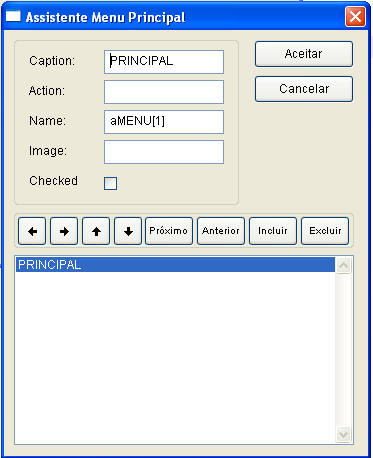

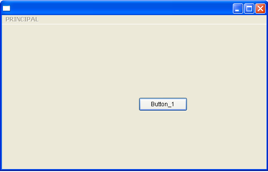

hello people can not assign a variable to a menu other than character
following example and the image
LOCAL aMenu := array(10)
Load Window Main
aMenu[1] := "MNU1" -- > does not work
cMenu := "MNU1"
Main.Center
Main.Activate
Load Window Main
cMenu := "MNU1"
Main.Center
Main.Activate

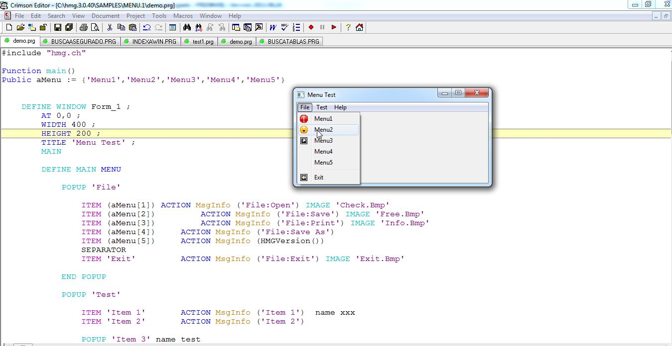

try this:
a modification of the example menu in hmg.3.0.40

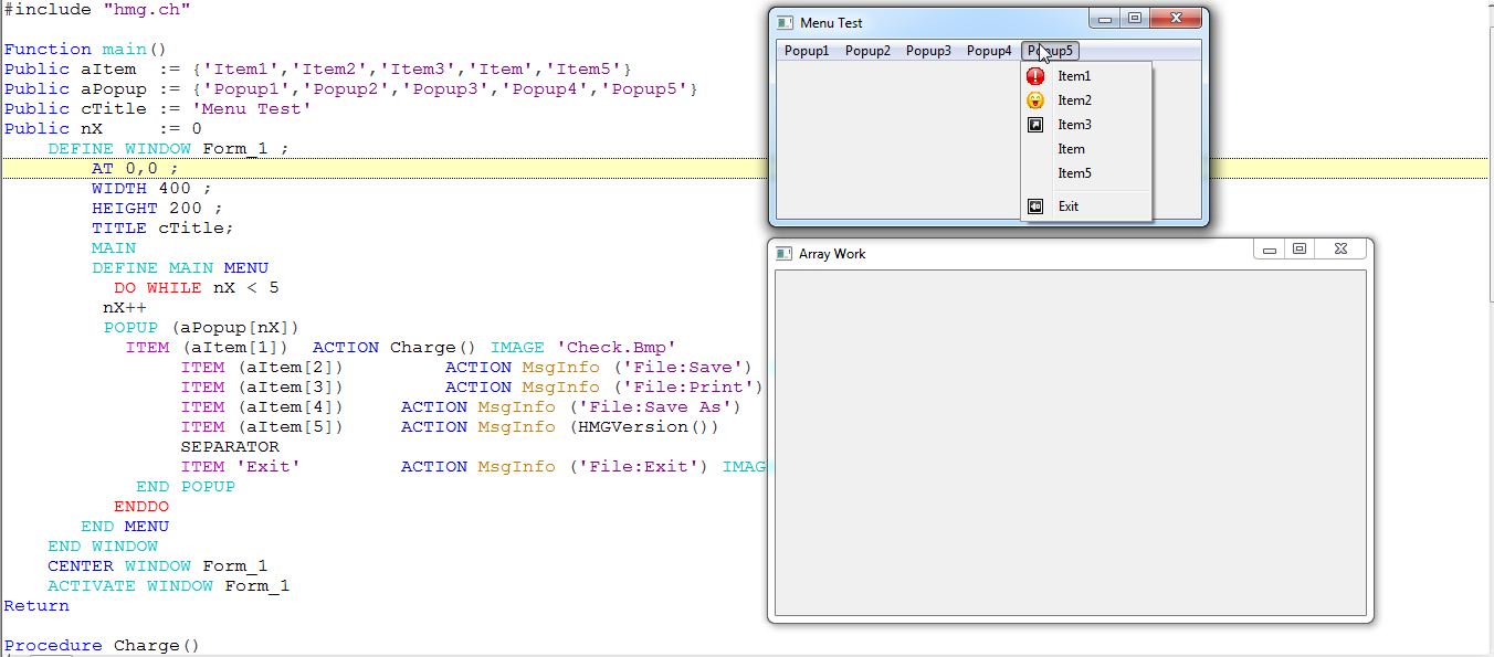

other ideas

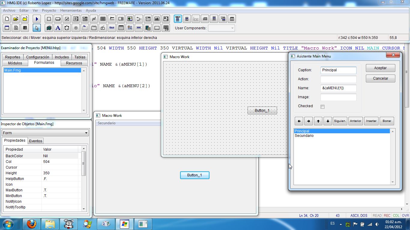

Ola Jair:
Try This Main.fmg
Try This Main.fmg
* HMG-IDE Form Designer Generated Code
DEFINE WINDOW TEMPLATE AT 342 , 504 WIDTH 550 HEIGHT 350 VIRTUAL WIDTH Nil VIRTUAL HEIGHT Nil TITLE "Macro Work" ICON NIL MAIN CURSOR NIL ON INIT Nil ON RELEASE Nil ON INTERACTIVECLOSE Nil ON MOUSECLICK Nil ON MOUSEDRAG Nil ON MOUSEMOVE Nil ON SIZE Nil ON MAXIMIZE Nil ON MINIMIZE Nil ON PAINT Nil BACKCOLOR Nil NOTIFYICON NIL NOTIFYTOOLTIP NIL ON NOTIFYCLICK Nil ON GOTFOCUS Nil ON LOSTFOCUS Nil ON SCROLLUP Nil ON SCROLLDOWN Nil ON SCROLLLEFT Nil ON SCROLLRIGHT Nil ON HSCROLLBOX Nil ON VSCROLLBOX Nil
DEFINE MAIN MENU
DEFINE POPUP "Principal" NAME &(aMENU[1])
END POPUP
END MENU
DEFINE MAIN MENU
DEFINE POPUP "Secundario" NAME &(aMENU[2])
END POPUP
END MENU
DEFINE BUTTON Button_1
ROW 150
COL 280
WIDTH 100
HEIGHT 28
ACTION Nil
CAPTION "Button_1"
FONTNAME "Arial"
FONTSIZE 9
TOOLTIP ""
FONTBOLD .F.
FONTITALIC .F.
FONTUNDERLINE .F.
FONTSTRIKEOUT .F.
ONGOTFOCUS Nil
ONLOSTFOCUS Nil
HELPID Nil
FLAT .F.
TABSTOP .T.
VISIBLE .T.
TRANSPARENT .F.
MULTILINE .F.
PICTURE Nil
PICTALIGNMENT TOP
END BUTTON

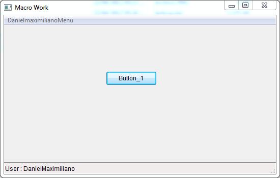

Hola Jair:
aqui tiene un ejemplo de utilizar una Macro "&" para crear menu personalizado.
Main.prg
Main.fmg
Main.prg
Public aMenu := {'JairMenu' , 'RobertoMenu' , 'DanielmaximilianoMenu', 'OtherMenu' }
Public aPopup:= {'Popup' , 'Popup' , 'Popup' }
Public aItems:= {'Items1' , 'Items1' , 'Items1' }
Public aUsers:= {'Jair' , 'Roberto', 'DanielMaximiliano' , 'Other' }
Public cUsers := getenv("UserName")
Public cPopup := 'Principal'
Public xMenu := 0
Load Window Main
Main.Center
Main.Activate
Function Mainname(cUser)
Local cMainname := ''
Do case
Case cUsers = 'Jair'
cMainname := aMenu[1]
xMenu := 1
Case cUsers = 'Roberto'
cMainname := aMenu[2]
xMenu := 2
Case cUsers = 'Other'
cMainname := aMenu[3]
xMenu := 3
Case cUsers = 'DanielMaximiliano'
xMenu := 4
Endcase
cPopup := cPopup + cMainname
Return (cMainname)
DEFINE WINDOW TEMPLATE AT 183 , 360 WIDTH 550 HEIGHT 350 VIRTUAL WIDTH Nil VIRTUAL HEIGHT Nil TITLE "Macro Work" ICON NIL MAIN CURSOR NIL ON INIT Nil ON RELEASE Nil ON INTERACTIVECLOSE Nil ON MOUSECLICK Nil ON MOUSEDRAG Nil ON MOUSEMOVE Nil ON SIZE Nil ON MAXIMIZE Nil ON MINIMIZE Nil ON PAINT Nil BACKCOLOR Nil NOTIFYICON NIL NOTIFYTOOLTIP NIL ON NOTIFYCLICK Nil ON GOTFOCUS Nil ON LOSTFOCUS Nil ON SCROLLUP Nil ON SCROLLDOWN Nil ON SCROLLLEFT Nil ON SCROLLRIGHT Nil ON HSCROLLBOX Nil ON VSCROLLBOX Nil
DEFINE MAIN MENU
DEFINE POPUP &("Mainname()") NAME &(aMenu[xMenu])
END POPUP
END MENU
DEFINE STATUSBAR FONT "Arial" SIZE 9
STATUSITEM "User : "+cUsers WIDTH 300 ACTION Nil ICON "Users" TOOLTIP "Usuario Logueado"
END STATUSBAR
ROW 90
COL 200
WIDTH 100
HEIGHT 28
ACTION Nil
CAPTION "Button_1"
FONTNAME "Arial"
FONTSIZE 9
TOOLTIP ""
FONTBOLD .F.
FONTITALIC .F.
FONTUNDERLINE .F.
FONTSTRIKEOUT .F.
ONGOTFOCUS Nil
ONLOSTFOCUS Nil
HELPID Nil
FLAT .F.
TABSTOP .T.
VISIBLE .T.
TRANSPARENT .F.
MULTILINE .F.
PICTURE Nil
PICTALIGNMENT TOP
END BUTTON
