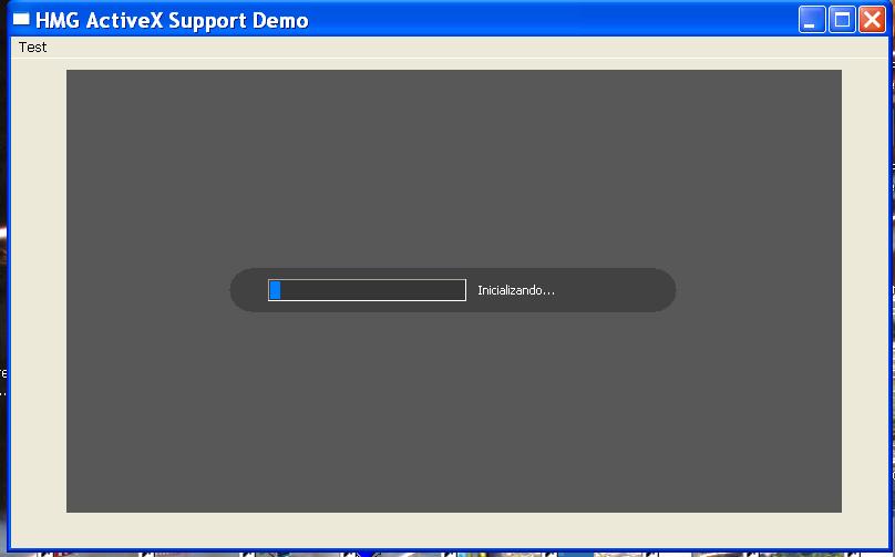

Hi all,
The example
C:\hmg.3.0.40\SAMPLES\ACTIVEX.7\demo7.prg
FUNCTION Main()
	DEFINE WINDOW Win1 ;
		WIDTH 800 ;
		HEIGHT 500 ;
		TITLE 'HMG ActiveX Support Demo' ;
		MAIN
		DEFINE MAIN MENU
			POPUP "Test"
				MENUITEM "Open File" ACTION Test()
			END POPUP
		END MENU
		DEFINE ACTIVEX Test
			ROW 10
			COL 50
			WIDTH 700
			HEIGHT 400
			PROGID "AcroPDF.PDF.1"
		END ACTIVEX
	Center Window Win1
	Activate Window Win1
Procedure Test()
//	Win1.Test.Object:src := curdrive() + ':\' + curdir() + '\' + 'readme.pdf'
Win1.Test.Object:src := 'readme.pdf'
does not run in my computer, it stops at:
I tried the same example in HMG Extended and works well.
Thanks in advance.
Best Regard,
Claudio Soto
Re: Help: Problem with ActiveX control
Hola Claudio
prueba reemplazar CurDrive() por la funcion HB_Curdrive()
 * Copyright 2002-2008 Roberto Lopez <mail.box.hmg@gmail.com>
 * http://sites.google.com/site/hmgweb/
 * Activex Sample: Inspired by Freewin Activex inplementation by
 * Oscar Joel Lira Lira (http://sourceforge.net/projects/freewin).
FUNCTION Main()
		WIDTH 800 ;
		HEIGHT 500 ;
		MAIN
		DEFINE MAIN MENU
			POPUP "Test"
			END POPUP
		END MENU
		DEFINE ACTIVEX Test
			ROW 10
			COL 50
			WIDTH 700
			HEIGHT 400
		END ACTIVEX
	Center Window Win1
Procedure Test()
	Win1.Test.Object:src := hb_curdrive() + ':\' + curdir() + '\' + 'readme.pdf'
Grande Daniel, funciona perfecto!!!! :D
Saludos cordiales,
Claudio
