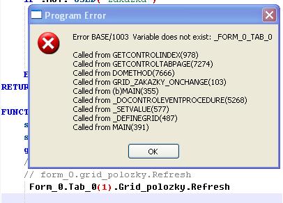

I have little problem. I have grid in tab. I can not refresh this grid. Look picture.
what is problem?

Even though it is placed in the tab, it should be referred as FormName.ControlName only.

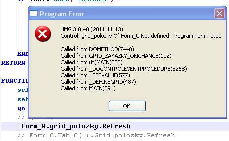

THX rathinagiri.
But when I try. Result is not OK.

I've met the problem like this.
Try to test if tab is already defined.
So add phrase to function GRID_ZAKAZKY_ONCHANGE():
if !IsControlDefined(TAB_0, FORM_0)
 return
From my observations (I didn't study sources of hmg) , controls placed on tab are defined before definition of tab, later the tab is defined and controls are added in tab at the end... So, this order causes problems while init time.
Strange...
Maybe I'm wrong?

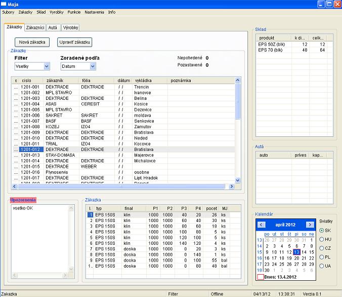

Post by dodogo »
THX Marek.
I handly edit file form_0.frm. I just remove grid_polozky to first position in Tab def. Every is Ok now.

Application GUI design looks nice Dodo. Cool.
