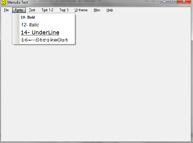

Maybe you can do this with "extended menu" of "MiniGUI extended". See the example at: <C:\MiniGUI\SAMPLES\Advanced\MenuEx\demo.prg>
See this image:
Rossine.
