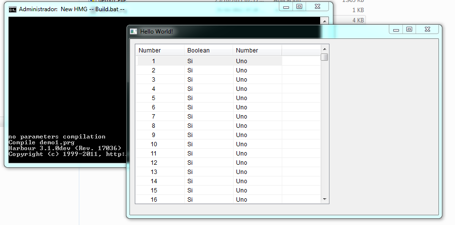

HI :
there is an error when compiling an application with Virtual Grid.
HMG reference say:
DEFINE GRID <ControlName>
VIRTUAL <lValue>
END GRID
Compile OK:
* HMG Virtual Grid Demo
* (c) 2003 Roberto Lopez
	public aElem := {}
	for i:= 1 to 1000
		aadd( aElem, {  i, .T., 1 })
	next
	DEFINE WINDOW Form_1 AT 0,0 ;
		WIDTH 650 HEIGHT 400;
		TITLE 'Hello World!' MAIN
		DEfine  GRID Grid_1
		Parent Form_1
		Row 10
		Col 10
		WIDTH 400
		HEIGHT 330
		HEADERS         {'Number'               ,'Boolean'              ,'Number'}
		WIDTHS          {100                    ,100                    , 100}
		Items aElem
		COLUMNCONTROLS {{'TEXTBOX','NUMERIC'  } ,{'CHECKBOX','Si','No' },{'COMBOBOX',{'Uno','Dos','Tres'}} }
		Value 1
		Virtual .F.
		Itemcount 1000
		End Grid
	CENTER WINDOW Form_1
	ACTIVATE WINDOW Form_1
ok virtual_2011-10-25_19-37-47.png (56.33 KiB) Viewed 7098 times

IF hb_IsBlock( ::aColumnWhen[ ::nCellCol ] )
IF !Eval( ::aColumnWhen[ ::nCellCol ] )
RETURN .T.
* Inplace edit area
::DefineCellControl()
METHOD DoKeyBoardEvents( e ) CLASS JKGRID
LOCAL oKeyEvent := e
LOCAL nKey := oKeyEvent:key()
LOCAL nModifiers := oKeyEvent:modifiers()
IF ::lCellActive //Already cell edit is in process, so don't process any key here
//functie-toetsen zou moeten mogen ?
RETURN .T.
IF !::lAllowEdit .or. ::lMultiSelect
* Nothing doing
RETURN .F.
IF ValType( ::aColumnControls ) == 'U' // no inplace edit required.
RETURN .T.
::nCellRow := ::nCY + 1
::nCellCol := ::nCX + 1
IF hb_IsArray( ::aColumnWhen )
IF hb_isBlock(::aColumnWhen[::nCellCol])
IF !Eval( ::aColumnWhen[::nCellCol] )
IF ::nCellCol == len( ::aColumnWhen )
RETURN .F.
::nCellCol++ // to navigate to NEXT cell IF columnwhen is not allowed
* Inplace edit area
If( nKey == Qt_Key_Return .and. nModifiers == Qt_NoModifier ) .or.( nKey == Qt_Key_Enter .and. nModifiers == Qt_KeypadModifier ) .or.( nKey == Qt_Key_F2 .and. nModifiers == Qt_NoModifier )
RETURN .F.
