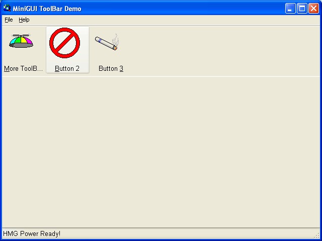

Hi Daniel,
Thanks for your request!
This feature will be available at the next Extended build.
Please take a look for attached sample below.
image-based toolbar in Win98
standard toolbar in WinXP
TOOLBAR-98.ZIP
image-based toolbar demo
(409.34 KiB) Downloaded 374 times
