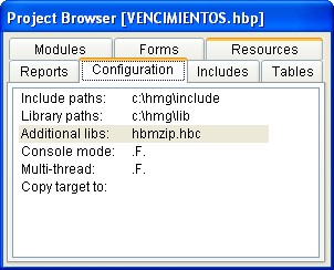

Hi Rathinagiri:
Rathi phenomenal: rename my settings, copy a new hbmk.hbm within my application folder. included in the ide lib hbmzip.hbc because that gave me an error again.
although not included in my project.
The application compiles perfect!!
Thanks for your work.
Fenomenal RATHI: rename mis configuraciones, copie un nuevo
hbmk.hbm dentro de la carpeta de mi aplicacion. en el ide inclui
hbmzip.hbc ya que esa lib me dio de nuevo un error.
a pesar que no esta incluida dentro de mi proyecto.
la Aplicacion compila perfecto!!!!
Gracias por tu trabajo.
Saludos/Regards

- vencimientos.jpg (27.33 KiB) Viewed 4434 times
Re: HMG 3.0.36 (2011-05-31)
Kindly save this code as build.bat in c:\hmg folder. Now you can use IDE in the new version. For console mode, still I could not compile using IDE. However, it can be compiled using build.bat in command prompt with /cr switch.
Kindly test and tell me your opinion. If everything goes ok, we can remove 'test' in the name!
