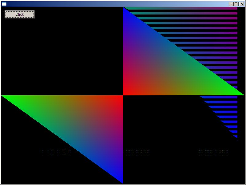

I tested it.
After building it showed distorted graphics. I closed it. Then I ran again. I showed following picture.

Yes Sudip, it is the incompatibility of Windows XP graphics drivers and openGL. :(
In Vista, it works fine.

I just ran the example on my XP netbook but suffered the same problem other users were having with distorted background imagery. I've done some OpenGL programming in the past & was able to solve the problem by adding the following lines in the c_graphics.c file.
glClear(GL_COLOR_BUFFER_BIT | GL_DEPTH_BUFFER_BIT);
glLoadIdentity();
The problem was that the screen wasn't being cleared before drawing, the lines above fix that.

Oh! That's great. Thanks a lot Mathew!
So, the problem is solved after a very long time! :)
