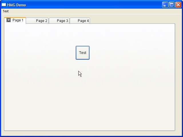

Please take a look for updated sample from your folder \hmg\samples\CONTAINERS\Tab below:
 * Copyright 2008 Roberto Lopez <mail.box.hmg@gmail.com>
 * http://sites.google.com/site/hmgweb/
Local aRows [20] [3]
	aRows [1]	:= {'Simpson','Homer','555-5555'}
	aRows [2]	:= {'Mulder','Fox','324-6432'}
	aRows [3]	:= {'Smart','Max','432-5892'}
	aRows [4]	:= {'Grillo','Pepe','894-2332'}
	aRows [5]	:= {'Kirk','James','346-9873'}
	DEFINE WINDOW Form_1 ;
		WIDTH 640 HEIGHT 480 ;
		TITLE 'HMG Demo' ;
		MAIN
		DEFINE MAIN MENU
			DEFINE POPUP 'Test'
				MENUITEM 'Get Image Picture' ACTION MsgInfo ( Form_1.Tab_1(1).Image_1.Picture )
				MENUITEM 'Set Image Picture' ACTION Form_1.Tab_1(1).Image_1.Picture := 'hmg.gif'
				SEPARATOR
				MENUITEM 'Get Button Caption' ACTION MsgInfo ( Form_1.Tab_1(1).Button_1.Caption )
				MENUITEM 'Set Button Caption' ACTION Form_1.Tab_1(1).Button_1.Caption := 'New'
				SEPARATOR
				MENUITEM 'Get Grid Header' ACTION MsgInfo ( Form_1.Tab_1(4).Grid_1.Header(1) )
				MENUITEM 'Set Grid Header' ACTION Form_1.Tab_1(4).Grid_1.Header(1) := 'New'
				SEPARATOR
				MENUITEM 'Set Grid Cell' ACTION Form_1.Tab_1(4).Grid_1.Cell(1,1) := 'New'
				MENUITEM 'Get Grid Cell' ACTION MsgInfo ( Form_1.Tab_1(4).Grid_1.Cell(1,1) )
				SEPARATOR
				MENUITEM 'Show Button' ACTION Form_1.Tab_1(1).Button_1.Show()
				MENUITEM 'Hide Button' ACTION Form_1.Tab_1(1).Button_1.Hide()
			END POPUP
		END MENU
		DEFINE TAB Tab_1 ;
			AT 10,10 ;
			WIDTH 600 ;
			HEIGHT 400 ;
			VALUE 1 ;
			TOOLTIP 'Tab Control'
			PAGE 'Page 1' IMAGE "exit.bmp"
				DEFINE IMAGE Image_1
					ROW	40
					COL	10
					HEIGHT	110
					WIDTH	230
					PICTURE	'demo.gif'
					STRETCH	.F.
				END IMAGE
			      @ 100,250 BUTTON Button_1 CAPTION "Test" WIDTH 50 HEIGHT 50 ACTION MsgInfo('Test!')
			END PAGE
			PAGE 'Page &2' IMAGE "info.bmp"
				DEFINE RADIOGROUP R1
					ROW	100
					COL	100
					OPTIONS	{ '1','2','3' }
					VALUE	1
				END RADIOGROUP
			END PAGE
			PAGE 'Page 3' IMAGE "check.bmp"
				@ 100,250 SPINNER Spinner_1 ;
				RANGE 0,10 ;
				VALUE 5 ;
				WIDTH 100 ;
				TOOLTIP 'Range 0,10' ;
				ON CHANGE PlayBeep()
			END PAGE
			PAGE 'Page 4' IMAGE "button.bmp"
				@ 50,50 GRID Grid_1 ;
					WIDTH 200 ;
					HEIGHT 330 ;
					HEADERS {'Last Name','First Name','Phone'} ;
					WIDTHS {140,140,140};
					ITEMS aRows ;
					VALUE 1
			END PAGE
		END TAB
	Form_1.Center
	Form_1.Activate
Hope that give you an idea :idea:

danielmaximiliano wrote:Hi Grigory :
try this
Procedure UnSelectPage()
 FOR nCounter := 1 TO nPage - 1
     Principal.Container_Tab(nCounter).Picture := "Unselect.bmp"
to select a tab page of the other pages should display an image
"Unselect".
Hi Daniel,
You are right!
The official HMG have only 'Caption(nPage)' property of Tab's pages for dynamical change at runtime.
BTW There is Image property of Tab's pages in the HMG Extended Edition, i.e.
Form_1.Tab_1.Image( 1 ) := 'Unselect.Bmp'
