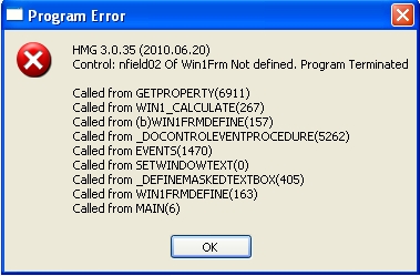

I found a malfunction during the use of the "OnChange" event in a control. I am referring to the HMG 3.0.35. I've attached an example that generates the error and this is the error.

Please try this :
And please don't ask me "why?",
because I don't know; simply tried and succeed (error gone away)
Please try this :
* calculate
STATIC FUNCTION Win1_Calculate()
IF IsControlDefined( Win1Frm, nfield01 )
Win1Frm.nfield03.Value := Win1Frm.nfield01.Value + Win1Frm.nfield02.Value

Re: onchange event on a control
Hi Luigi,
It is possible to fire the change event even before activation of window. Actually it is what happening here.
You have hooked the on change event of nfield01. When the value is changed, it refers to nfield02, and nfield03 which were not at all defined at that time! That is why the error is occuring.
Actually Setting an INPUTMASK to a textbox changes its value to 0.
So, it is safe to check whether the other controls (or the last control) are defined.
