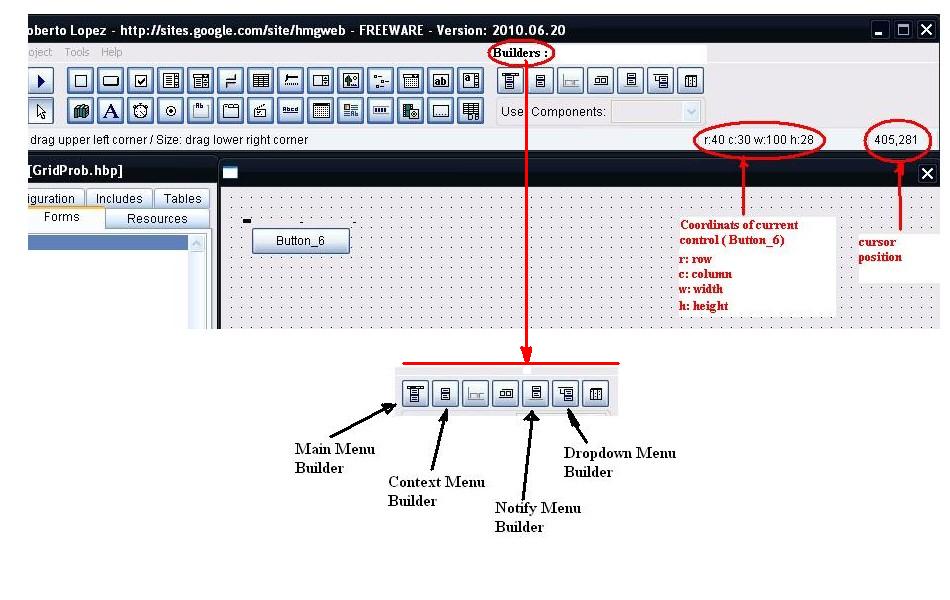

1. How do I create the main menu (pop up with items) in HMG IDE? I can't seem to display it in the form.
Some hints for HMG IDE
Please look at attached image; I hope that it have an answer to your question. IDE include "builders", no for only main menu, for other type menus too.

3. I'm using a screen ruler (MWSnap/FastStone Capture) to position objects. Is there a better way (aside from HMG IDE, of course)?
I haven't any idea about tools you are talking about. But HMG-IDE has two perfect features for tracking screen coordinates: coordinates and size of current control and current cursor position. Please look at attached image.

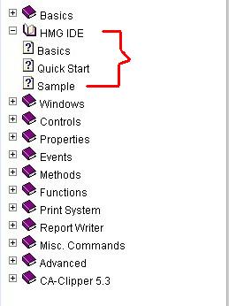

Documentation too discussed for various aspects. In summary, IMHO, HMG reference manual is a perfect source and except for a few conditions it's unnecessary a separate user's manual. More important, HMG is a very dynamic project; everything changes with extremely high speed, so almost every reference source will become stale quickly. Please take a look to very beginning topics (beginning with What is MiniGUI?, continuing with Quick Start and Simple Tutorial 1..17 ) of HMG General Help forum; simply to HMG Oficial Help. I hope that all this information is sufficient for newbies.
In other hand HMG Doc also include a little but helpful section for IDE:
IDE Section of HMG Doc
Yes, the ruler function is built into HMG IDE but I can also use the screen rulers over running program windows. Actually, I was forced to use the screen ruler because I did not know how to use the IDE (ie, can't even make a menu). Notepad ++ as text editor + MWSnap to count screen coordinates, that's how I made my program. As soon as I know HMG IDE, I may no longer have use for screen rulers.
