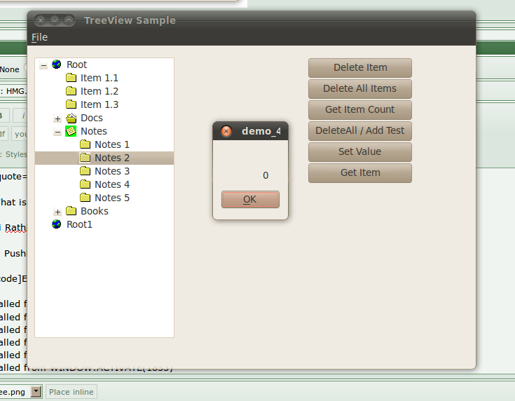

OK. I have compiled and checked all samples. Only two controls did not work right right away. I posted the issues on the developer table. Tree and slider had problems, but that has nothing to do with Linux. It is just, because the HMG-code is not completed.

What is the problem you have got in tree?

rathinagiri wrote:Hi Raumi,
Hi Rathinagiri,
1. Pushing the button GetItem leads to runtime error:
Error BASE/1004  No exported method: SETTEXT
Called from SETTEXT(0)
Called from TREE:ITEM(144)
Called from (b)MAIN(104)
Called from QT_QAPPLICATION_EXEC(0)
Called from QAPPLICATION:EXEC(0)
Called from WINDOW:ACTIVATE(1853)
Called from MAIN(109)
2. Delete Item / Delete All Items does not do anything
3. Get Value Tree Value always returns 0
Other than that, it looks great in Ubuntu 10.04!
By the way: I like your new picture.
Raumi
Screenshot of tree-control on Ubuntu Linux 10.04
Re: HMG.4 For Linux New Binaries+Source Release [RE-RELEASED
I think you are using the old version.
Please update to the new version. :)
