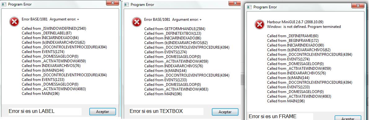

I am having an error that seems very strange, I have something like this:

For each control that is trying to define a different error, which for ease of reference, annex image.
What am I doing wrong because I can not find the solution.

Re: About errors in the definition of controls
Hola Javier
Debes definir un nuevo formulario sobre los que se generarán los nuevos controles dentro de la función IniciarIndexado()
Translated by Google.
Thanks for reply, Adrian, as he tells me of course, opens a new window, and in this case, the behavior is not what I want at the moment I've settled with the OF parameter, thus:
IniciarIndexado Function ()
@ 420.300 cText LABEL VALUE "Text" OF frmIndexar
OK Javier
Independientemente de la lógica de la interfaces que busques, el hecho es que los errores _ISWINDOWDEFINED(2540) y GETFORMHANDLE(2584) hacen referencia, justamente, a la inexistencia del puntero o manejador de la ventana que contiene a los nuevos objetos.
Lo que sucede es que cuando la librería genera el mensaje de error para dar aviso de la falta de definición de la ventana contenedora, se produce un error de ejecución al intentar concatenar la correspondiente referencia:
En h_textbox.prg : function _DefineTextBox
// Check if the window/form is defined.
if ( .not. _IsWindowDefined( cParentForm ) )
MsgMiniGuiError( "Window: " + cParentForm + " is not defined. Program terminated." )
Thanks for the explanation Adrian, my idea in this particular form is present throughout the user interface, and if accepted the process of starting the indexed files, passing parameters as the names of the main window and cdxs dBFS and rate of progress etc..
