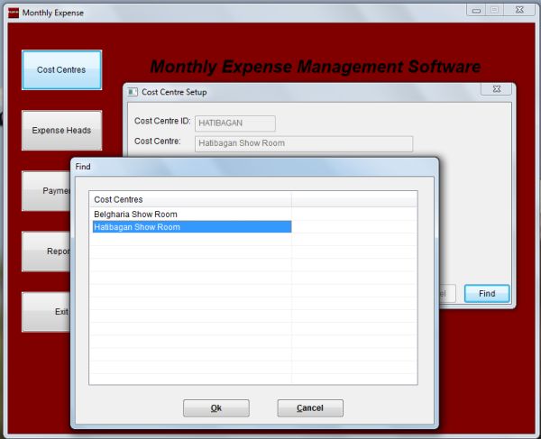

Most of my apps are using Grid as incremental search control when CellNavigation is .f. :)
But when Grid is used with table, CellNavigation becomes .t. and this feature is off. And I am using DBFCDX in my current project ...
A few months ago, I requested Roberto to give option to set CellNavigation to .f. in case of Table Grid also for that reason ... :)
After some time:
At last I can manage to do it with a normal grid (array). I tried my best to make it generic :) But, it may become slow for large dbf tables ;)
